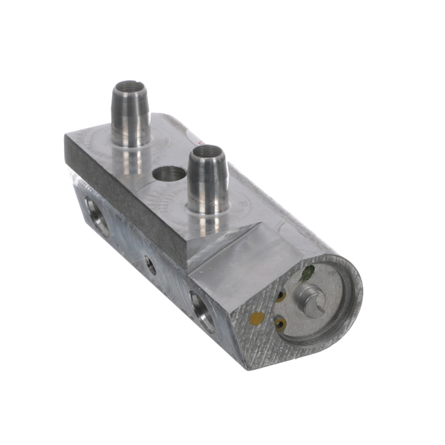

GM released a new thermostat for 6L80 and now for 6L90 in T1 HDs to lower transmission operation temperatures.  The new thermostat has a full open point of 158F.  Lower temps promote longer fluid life and still allow the transmission to operate in GM's fluid hot check range of 160-200F, which is really their ideal trans temp operating range, and also falls in the lower end of TCI's range.

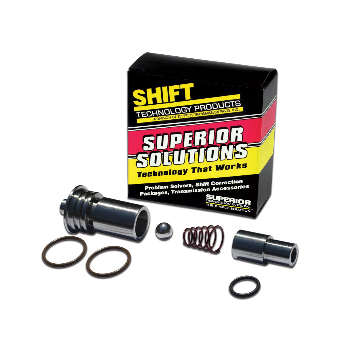

Those not new to GM's trans thermostat know of two other methods to control transmission heat.  The "Pill Flip" and the Sure Cool thermostat delete kit.  Both are effective ways to bypass the thermostat and allow for much lower transmission temperatures and longer fluid life.
Valve 86774933 | QuirkParts
Must Have - Superior 6L80 6L90 SURE-COOL Cooler System - Easy-to-Install

No gasket. New gasket part # 23135703 I have reused them.
42 minutes ago, DeePa said:
Part number?
id like to do this asap. I’m already 20k into my second trans. Replaced at 107k. Currently at 127k
TBV part # 86774933
