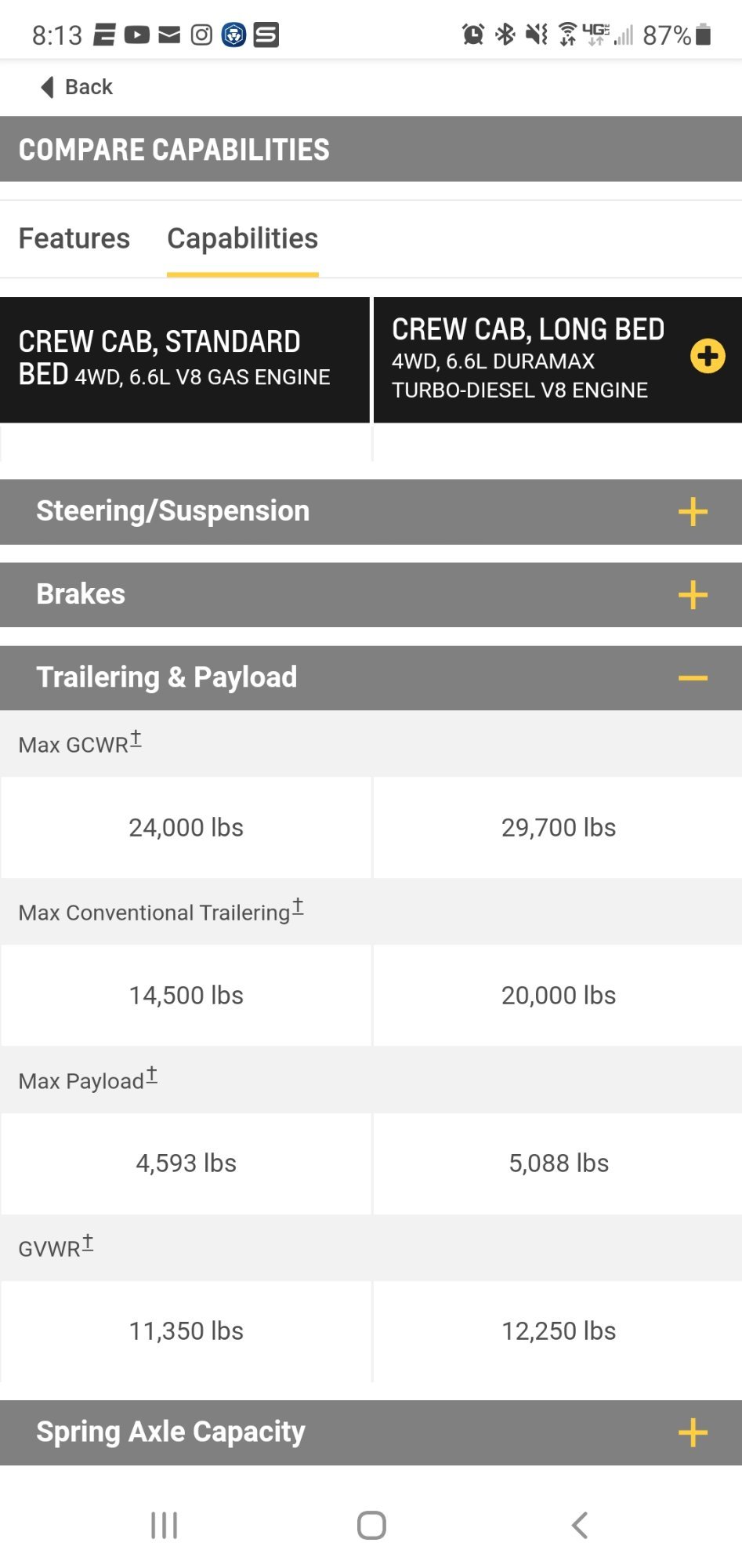

Google "2022 Chevrolet 3500 HD payload capacity" and the same for GMC.  They are different capabilities with Chevy having a significant edge in both payload and towing capacities.....why I don't know.  SRW is of course lower than DRW in both and Duramax significantly more capacity than gas.
