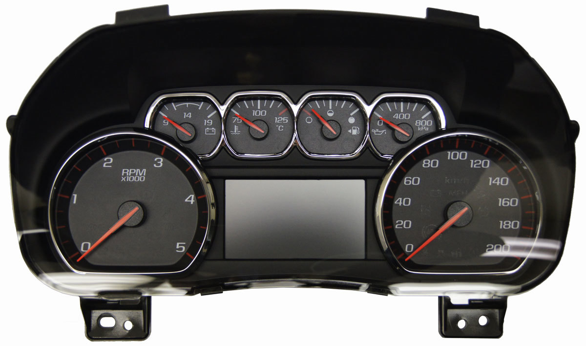

Just asking, but do they change the cluster for the US market, when it is sold here, or would it still look like this?
See the source image
Edited by JimCost2014
Aren't the US speedos 140 dials rather than 200?
(so that at 60 mph the US cluster would have the needle at the 12 o'clock position, same as a metric cluster does at 100 kph)
Obviously the gauges that are painted cannot change their units, but the speedos can highlight the other (mph / kph) on the dial face and move the needle to the correct location.
I've imported a us vehicle (not a gm pickup) and it had both sets of units painted on the dial -- US version of the vehicle the MPH font as larger, Cdn version of same vehicle the kph units were more prominent. But both would indicate the
Trim level changes cluster too.
