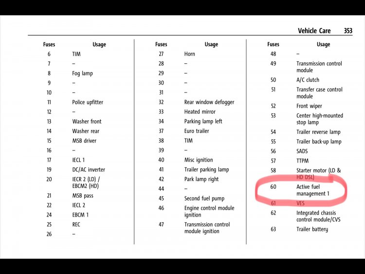

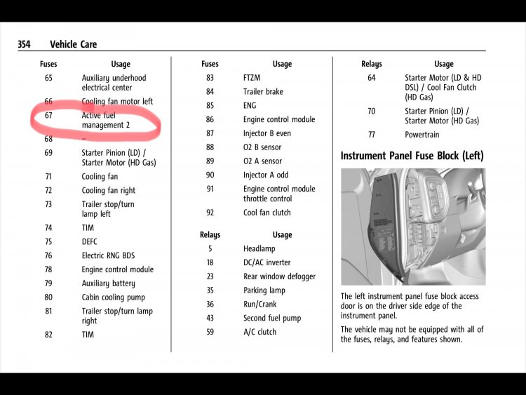

On the Trailboss forum some guys are pulling the DFM fuses to disable it.   They are pulling fuses 60 and 67.   All that did it have no issues or check engine lights.
I was thinking doing it but wanted to see if anyone here have done it to there trucks.
Here is a link to there topic
https://www.trailboss.org/threads/pulling-dfm-fuse.481/
You have my attention. I currently drive our truck in L7 to disable DFM, but that would be super convenient if pulling those two fuses works as then I could just put it in D.
I also would be curious for anyone with a '21 that was built without DFM has those two fuses present or not. If the non-DFM 5.3 and 6.2 trucks don't have fuses 60 and 67 from the factory, I would view that as a good sign that it's an effective method.

Just checked. I have 60 & 67 and DFM is not installed on my 21.
Thanks for checking.    I was going to ask if someone could comfrm that.
I bet they programmed it off.    They probably use the same fuse block as before and just leave the fuses in.
