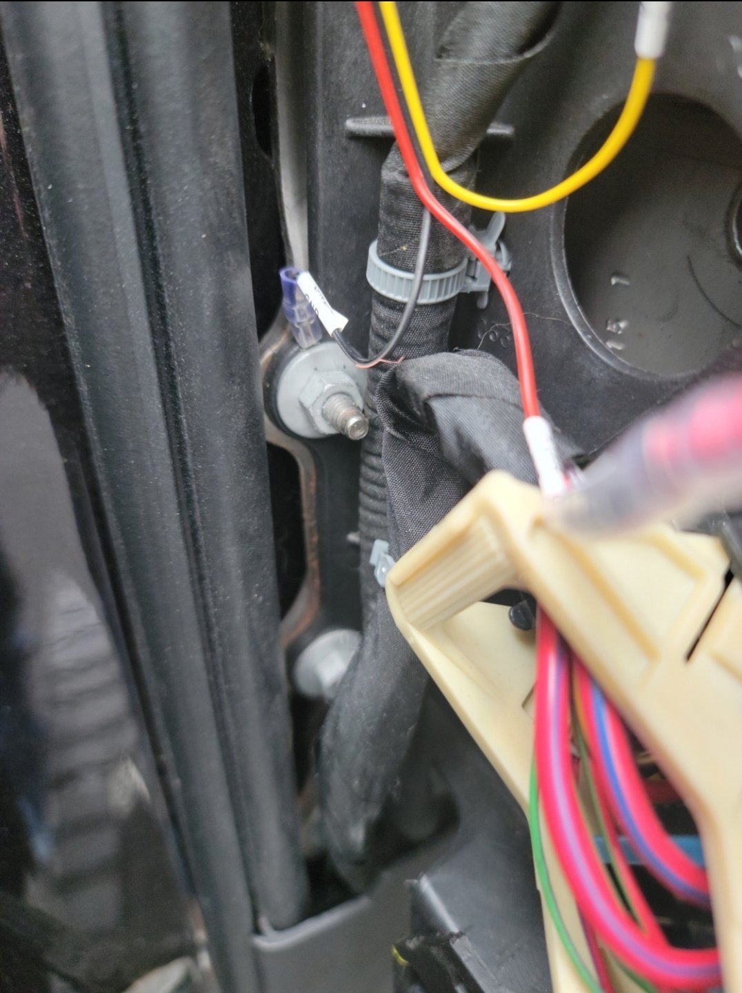

Ok, here is how I did it on my 2016. I used fuse #31 for power when truck is in ACC or On. I used fuse #36 which was a spare that is hot all the time. I also used a bolt to the left of the fuse panel to get "-" ground. So looking at the wires, the yellow wire is connected to fuse #31 and red constant is connected to the spare fuse #36.

fuse #36 is fine for constant power,but i wouldnt use #31 for switched power. thats for run crank. You can use the large purple 50 amp APO RAP# 10. Thants switched power when key is on
Doing a little searching, it looks like Fuse #30 could be a good option for switched power. It is for Special Equipment Options (Upfitter) for Automatic Leveling Control and is supposed to be switched power. Since I don't have automatic leveling control, it should be an unused circuit. I don't have my multimeter handy right now but will check it. Also Fuse #32 is unused as I don't have the heated steering wheel option but should be switched power as well. However it is only a 7.5 amp circuit and the dashcam instructions recommending using a 10amp circuit. Not quite sure why as this switched power would be running power to a USB power source and those are low draw items...
Ok, @benelli so your comment about using fuse #31 "Accy/Run Crnk" made me curious. I still don't have access to my multimeter so I did the next best thing, played with the connections. I pulled that yellow wire for the dash cam (Accessory) and left it disconnected and then pulled the red wire (Battery) from fuse slot #36 Spare. I stuck the red wire into #31 and turned the truck on. I had to push power button on dashcam but it came on and worked just fine. When shutting off the truck, then opening the door, the dashcam turned itself off within a couple seconds.
So then I put the 10a fuse by itself back into the #31 slot. Next, I pulled the 15a fuse out of #30 and put that into the piggyback fuse holder and then installed the red wire into that slot. I started truck, then again had to push power button on dashcam and it came back on and worked fine. I shut truck off again and opened door. Within a couple seconds, the dashcam turned off like it's supposed to. I skipped the #32 7.5a Htd Whl but I'm assuming it would work just the same as #30 and #31.
So just to be safe, I piggybacked  the #30 15a fuse with the yellow dashcam Accy fuse holder and put that in the #30 slot. I then put the #36 fuse into to the piggybacked slot with red wire and put that back in the #36 slot. I turned truck on and this time after a few seconds, dashcam screen automatically turned itself on and began to work. I shut truck off and opened the door and within a few seconds, dashcam screen turned off. It also would do the same using the #31 fuse like I had been using since the start. But I did take your advice and am no longer using the #31 fuse but instead am using the #30 instead as that is essentially a spare anyway...
When my dashcam is hooked up with both the yellow (Accessory) and red (Battery) the dashcam also has the parking mode ability. It records normally when truck is on and then automatically switches to parking mode shortly after truck is turned off. But I also now know I can just use the red wire in either #30, #31, and most likely #32 fuse slots and just operate the dashcam manually. They all do provide power when truck is on and then all cut power when truck is shut off. There were a couple other fuses that looked like they would work just as well but since I already had 3 working options, I didn't go any further.

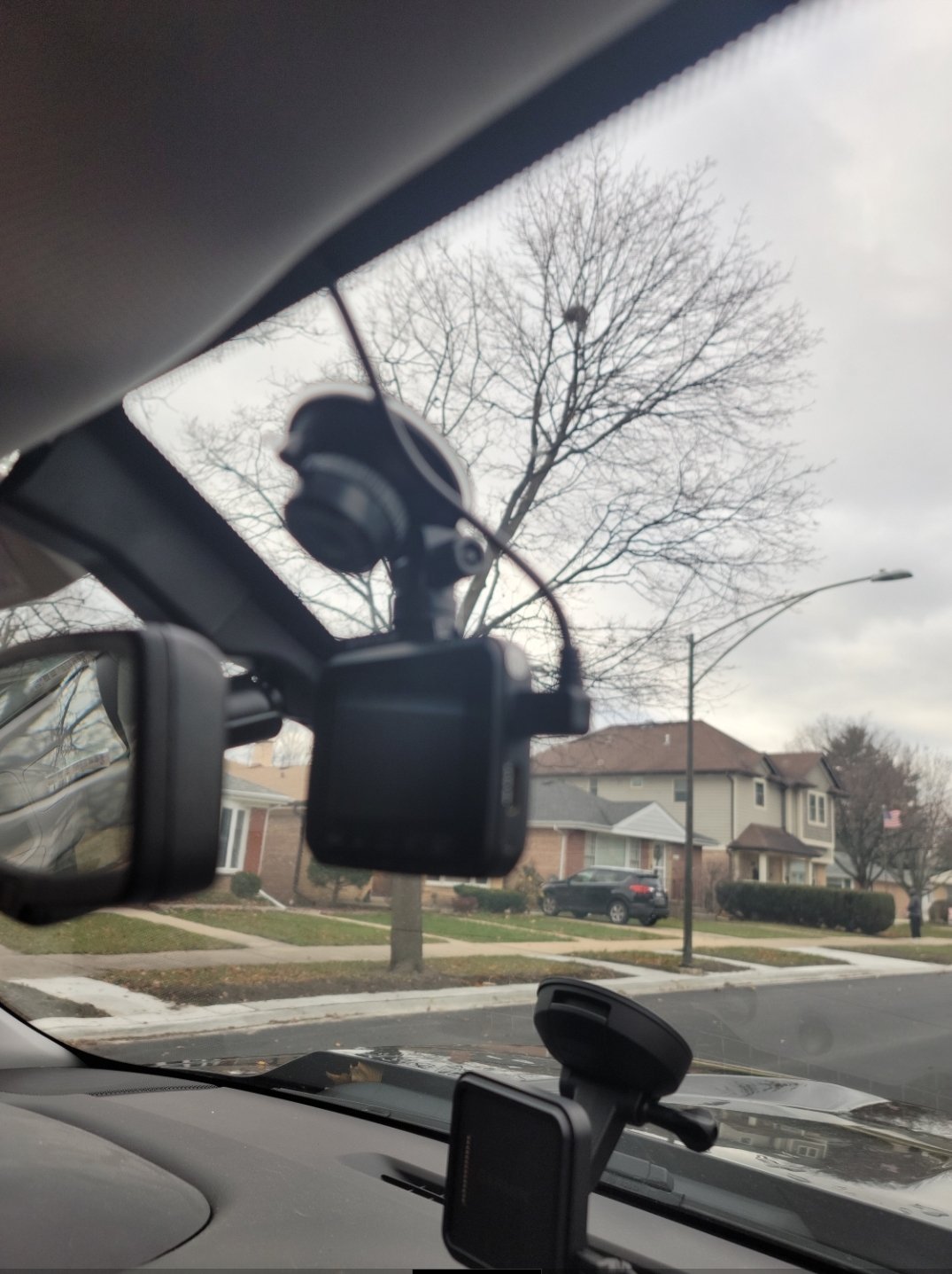

I only have a forward facing one, Rove R2-4k. It is advertised as a 2.4" screen but I really don't watch the screen anyway. I can turn on the wifi on the camera and link it to my phone to review the recordings. It will record audio or you can turn the microphone off if you want. It is mounted with a suction cup and I have it tucked behind the rear view mirror. It has a very wide field of view (150⁰) and then has software correction to make the videos appear normal. I use a 512gb micro sd card on it. It is continuous recording while driving in 3 min clips IIRC and overwrites the oldest videos. You can set up the parking mode to offer 1 frame per second or to activate when it experiences the set g force and then will record for a 1 min after that. It offers to lock a video clip instantly if needed to save it and those won't be overwritten.
