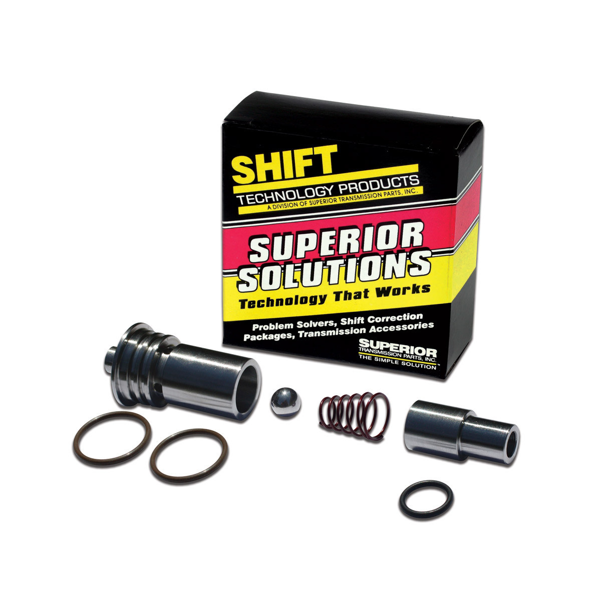

With a kit like this, what benefit does it have versus flipping the pill?  Something about pressure equalizing or bypass?
The theory is that IF the cooler is plugged by viscous fluid then the kit provides a 'short circuit' back to the pan so that the pump doesn't dead head.
