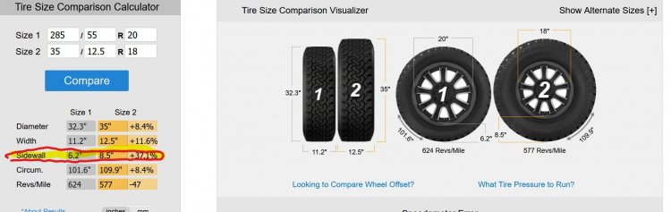

Probably the tires and rim size.
I have 35x12.5x18s and, after the 5100 install. it rides great!
Prior, with the stock shocks, I'd bounce way more than I liked.
I, also, notice a difference on tire pressure - at 45 PSI, it's harsher so I keep the BFG K2s around 39 PSI.
