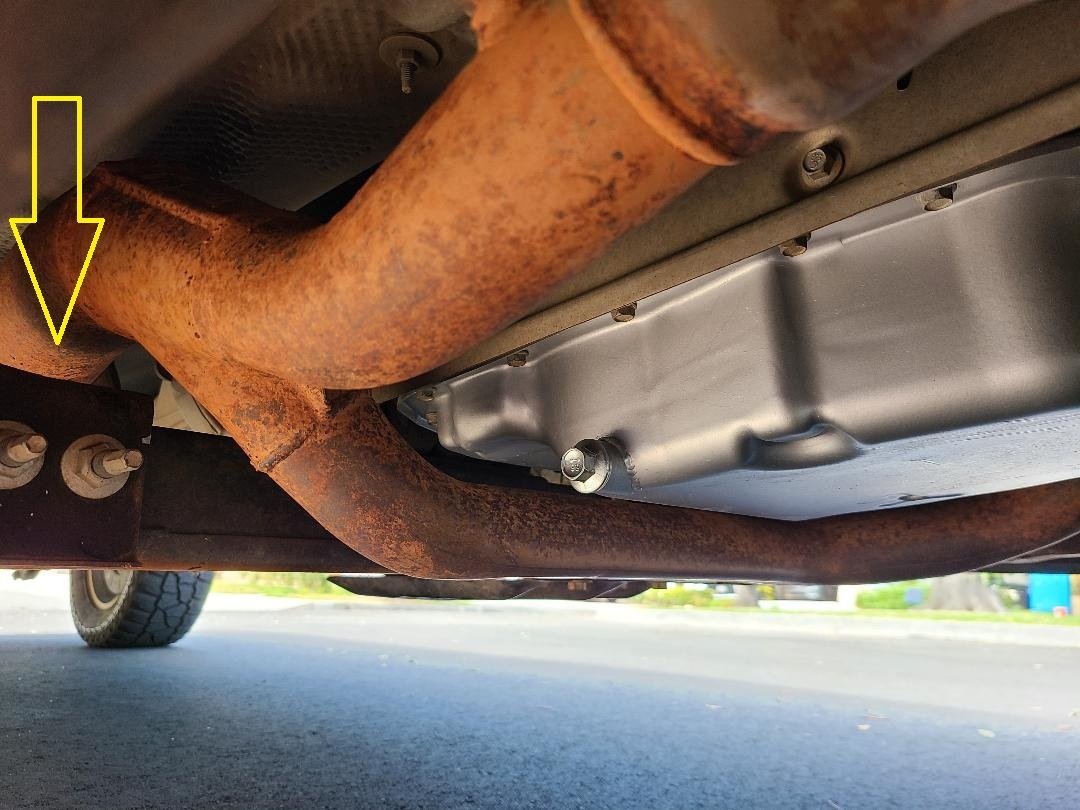

I used one Harbor Freight ratchet strap ~$8 and just looped it around the pipe behind the Y and the crossmember.  I cranked it down to almost touching the crossmember, and didn't loosen or remove any supports or the manifold connections, nor did I loosen the transmission mount and raise the transmission.   I was pleasantly surprised when the pan just twisted a bit and came out.

Not nearly as bad as I imagined.  I ran my truck up on 5" race ramps placed between the front and rear tires and backed up the ramps, chocked it, set the brake.  You could use a jack and some blocks or jackstands instead.  My driveway is slanted and I don't like to use jacks or stands when working under a vehicle, so I use ramps or blocks when possible. This allowed more room to work under it, got the ramps out in front of the front tires and allowed side access, as well leveled my truck in my slanted driveway.   Placing a large sheet of heavy plastic down saved a lot of cleanup of the driveway. It was worth whatever that plastic sheet cost.   I used a ratchet strap as mentioned above and didn't loosen or jack anything.  But I think the thing that helped me was pulling the line and purging all the fluid out before dropping the pan.  The pan only had about a quart or less in it when I did drop it.  So it was easy to maneuver around and get it out.  I was prepared to loosen the trans mount and jack it, but it just wasn't necessary.  The cheap chinese ratchet strap sorta folded the sideplates when I tightened it, so I simply cut it loose after the pan went back on.

It simply took one ratchet strap pulling down the exhaust to the crossmember, without unhooking anything on the exhaust. I thought it was about the simplist way to deal with the exhaust.  No muss, no fuss.
