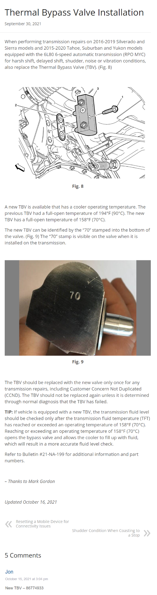

This may be old news to some, but I ran across this Service Bulletin "#21-NA-299 - Information on Installation of a New Thermal Bypass Valve (TBV)" where GM now does the "Hack" with a new up-dated kit. I think the P/N is 86774933 but you can read the Bulletin here. I'll paste a copy below in case the link doesn't work. Now GM wants the transmission to operate @ 158 F (70C) instead of the 194 F (90C). I did the un-official change over when I got my truck & transmission runs so much cooler & better.

I will have the new valve and gasket soon and am going to do this. One thing is that I have found information about Service Bulletin 21-NA-299 but not the actual Service Bulletin. The changeover should be simple enough because I also did the pill flip on mine earlier this year. I should have done it a long time ago. One big difference between the pill flip mod and using this new valve is that full cooling happens all the time with the unofficial mod but won't happen until 158⁰ F with the updated valve. But that is still a tremendous improvement over the original 190⁰ F valve...

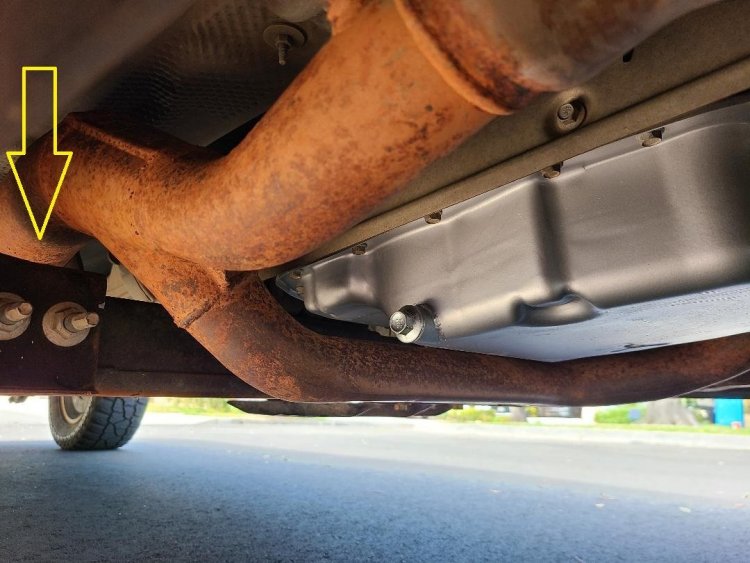

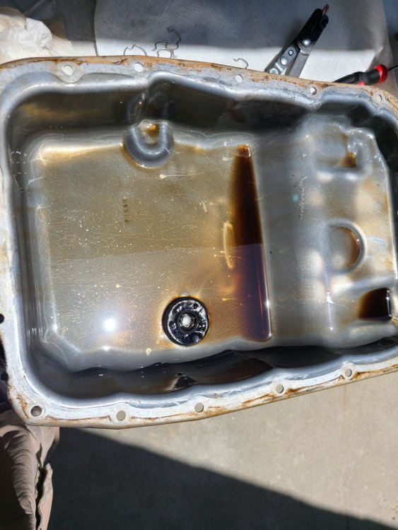

Didn't take long to find the problem. I forgot to make sure that the o-ring was on both cooler lines. One had it and one didn't. Doh! So this will be an easy fix but hopefully no damage was done... I had to make a run back up to Wisconsin place in my wife's car. A quick check in the oil pan I had under trans and I found the missing o-ring. I will tackle it again tomorrow. I picked up 2 gallons of Dexron VI to replace the missing stuff. Not sure how much got lost...
So quick tip, make sure the o-ring is on both trans fluid cooler lines before tightening them down. On a positive note, had this happened and I was running the pill flip mod, I probably would have ended up far worse off. And I knew better too because I saw them the first time when doing the mod. I got careless.

Great writeup. Hope there is no damage. I wonder if the temps would be lower if the oil was going to the cooler instead of all over the bottom of your truck. The missing "O" ring. Was that the top or the bottom line?

I got the missing o-ring back on. It was on the lower cooling line. Got it all buttoned up then started the truck to get trans temp to around 70⁰ F for cold fluid check and it was probably about a quart or so low so I added some. (I had to go with Castrol Transmax Dexron VI full synthetic because that's about all I could get late on a Sat nite.) Then while still parked  I ran it through the gears and then kept pressing brake and accelerator to get the temp above 160⁰ F. It didn't take too long and now a check showed it barely reaching bottom of dipstick. What a pain it is to not know how much fluid was lost because it took forever adding, running through the gears, letting the fluid settle out of fill pipe and then trying to read that stupid dipstick. If I was doing a fluid exchange, I could just add the amount I took out and it would be good. I ended up adding a tad over 4 qts and was able to get it to top of "Hot" hash mark.
But it looks like I dodged a bullet. No unusual sounds coming from trans, harsh 1st to 2nd shift gone, and no more slipping. It seems to be acting normally. I drove it to the car wash several miles away to get the undercarriage and back end cleaned off. I did a couple hard accelerations as well as some normal stop and go driving. Before leaving to go  the trans temp was around 172⁰ F because of getting it warmed up for fill. It never went above 176⁰ F but stayed mostly in the 174⁰ F range. Outside temps were mid 50⁰'s.

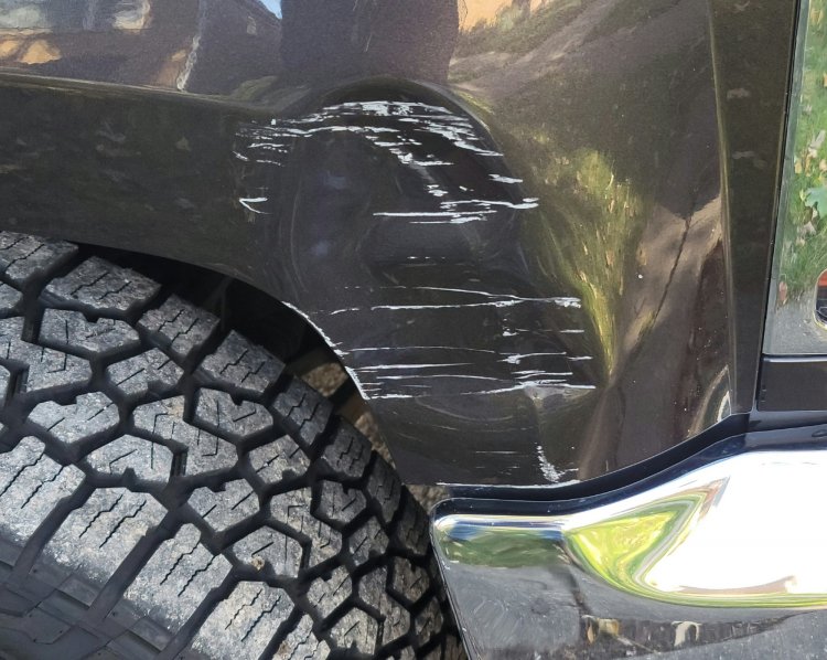

Worst thing so far was the customizing of my right fender last night when trying to get close to the garage. The alley is unfortunately narrow and garage door isn't high enough to pull truck in. That's the main reason I don't do anything here and do all the maintenance up at other place. But last night, I didn't have a choice. There is a chain link fence that is lower than front end so it is a serious blind spot and while trying to maneuver past it to park in front of overhead door, I clipped it. Bumper was fine as it looks like I only caught the cap and top clamp. Unfortunately that will not buff out...

You just had to add in the deer comment and jinx me... Not nice, LOL! Last deer I tangled with was almost 20 years ago while driving a 99 Tahoe. Got almost an entire new front end.
The photo looks way worse than I think it is. It looks like if I go with OEM wide fender flares (although not a big fan of them) they just might be wide enough to make it disappear. I found them listed at $280 which would be way cheaper than body work.
Although a deer strike would get the entire front end fixed with insurance and no more worries. Just thinking out loud...
