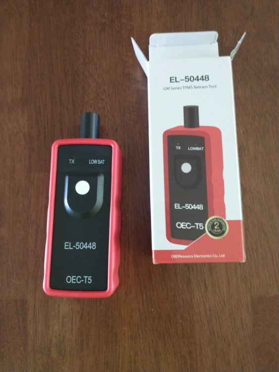

I just happen to be going through something similar. Bought new wheels n tires with new sensors. They are schrader 315/433
I can activate the relearn, 2 beeps,  and tried the air down method found on YT,  but no horn sound. I read a bit further and found the new 2019 LT would need the relearn tool.
So I purchased JDIAG EL-50448 TPMS relearn tool for GM sold on Amazon... so we`ll see if that does it...

update, received the relearn tool today, and went right out to the truck to try it out. Bazzinga! it worked great. heard the horn beeps went onto the next until done. display now shows the tpms. From what I know DTD installed Schrader brand 315/433 dual freq sensors in the new wheels... So glad I got this done, and for $12.xx for the tool, def worth a shot...

Correct, the airing down method may have only worked up until 2013 for trucks and 2014 for SUVs.  I bought the tool myself 2 years ago for around $15 on eBay.  Have used it twice since.

Thank you, so far so good.
