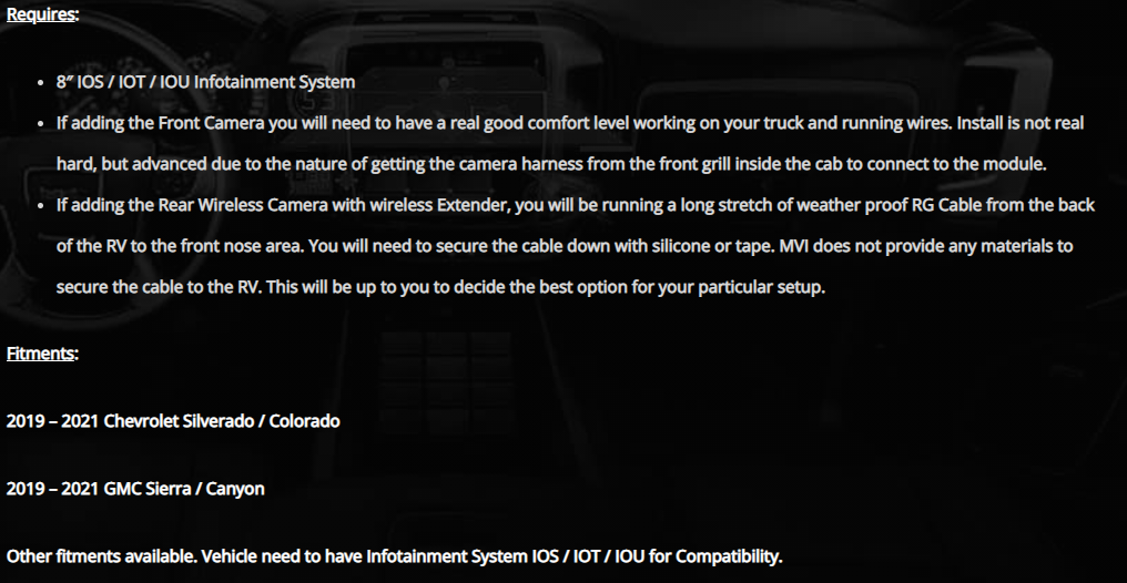

I do have the ios infotainment system.  That was not the same video that I watched.  This is the one I watched, kind of confused a little as to whether the echomaster intellihaul module/system is factory?

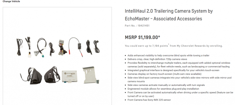

The base InteliHaul system 2.0 is $1200

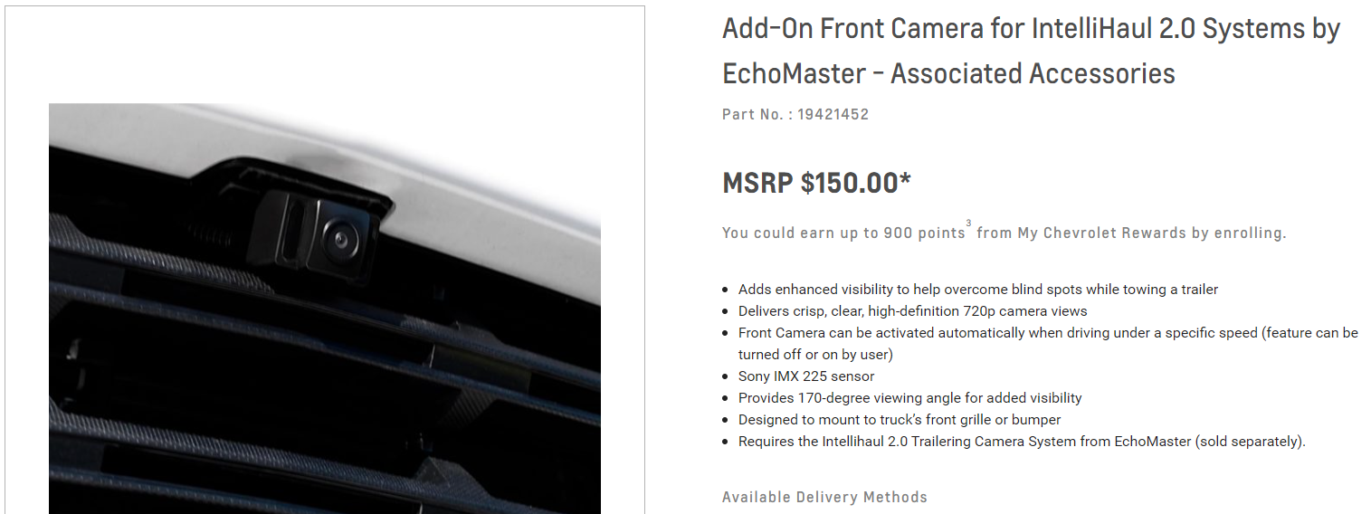

Add on Front Camera add on is $150

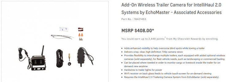

Add on Wireless Trailer is $408
