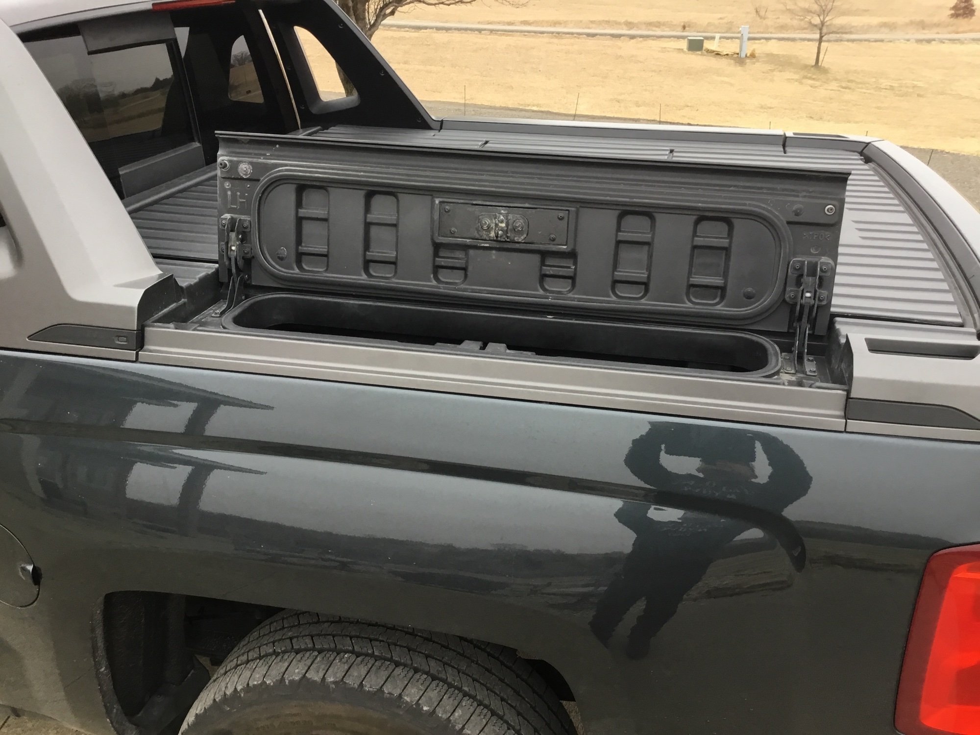

The High Desert package consists of an electronic controlled magnetic ride control and what most people recognize is the bed system because it is the most noticeable. It is a complete drop in factory installed system that come with tool boxes
(large beer coolers) down both sides that are very similar to the Chevy Avalanche. They both lock with the vehicle remote like the tailgate. It has three removable covers that allow for large cargo. It also has an area inside that raises to secure small or large cargo, depending on what side of the divider you put your cargo on. I believe it was only available in the 69 inch bed. It also has a support piece that runs up behind the cab, looks just like a Chevy Avalanche, that contains a third brake light.
I just purchased a 2017 High County, 6.2L with the High Desert package. No disrespect to anyones person opinion, but I don’t care for the Avalanche look. I plan on removing it this weekend. If anyone is interested I would like to trade for a nice trifold flat bed cover or sell it for enough to buy one.
