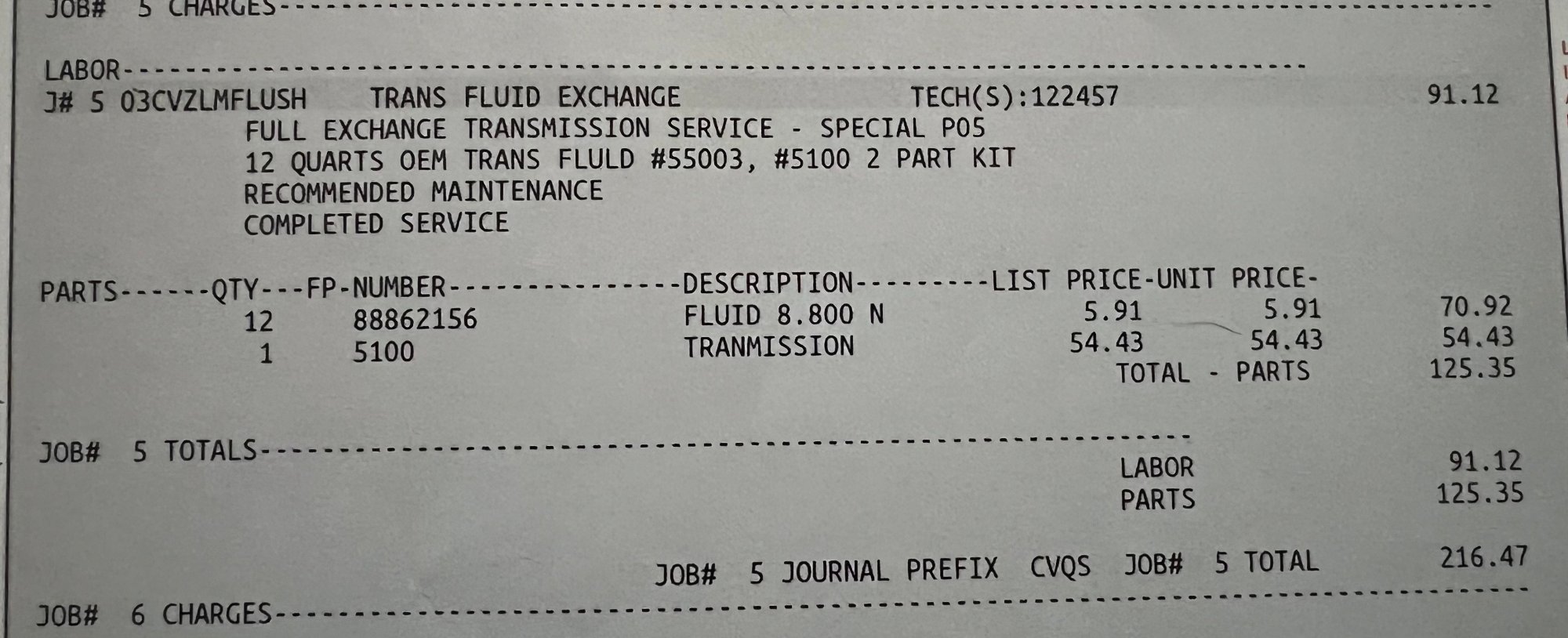

I dunno, I just have the transmission fluid change and flush done at the dealer. Never asked what they put in.
After 81,000 miles, still works a treat and I have someone to blame if it doesn't.
JMO
