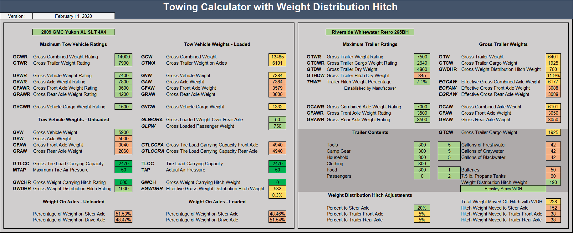

For example if you want to pull a 10,700 pound trailer, you'll want at LEAST 10% of that on your tongue so that is 1,070 pounds, 12 percent would be more stable, that would be 1,284 pounds which leave you with 259 pounds for the driver and any passengers, the hitch and stuff.  Does this make sense?
Here's an exmaple with the towing calculator I made for my vehicles:
