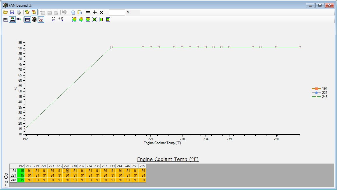

I had my tuner change my fan control to this:

Tuner went with a more aggressive fan settings,i towed again,temps came up again,not quite as hot.Yesterday I swapped in a new ac delco thermostat,took it out and drove it empty on flat ground,cruise at 207*,temps would fluctuate more than I think they should.
