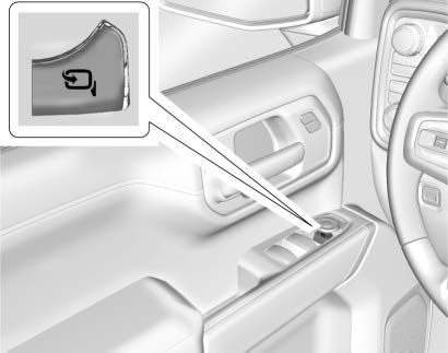

To unfold the mirrors while walking to the truck, push and hold the fob unlock button.
I'm a sometimes user of this feature.
I've never figured out a way to move the mirrors with the lock/unlock button on the outside of the door.
Remote Mirror Folding
If equipped, press and hold 'lock'  on the RKE transmitter for approximately one second to remotely fold the exterior mirrors.
Press and hold 'unlock' on the RKE transmitter for approximately one second to unfold.
This feature can be turned on or off.
See Vehicle Personalization pg  130.
Of course they can also be folded/unfolded using the button on the inside of the door.
