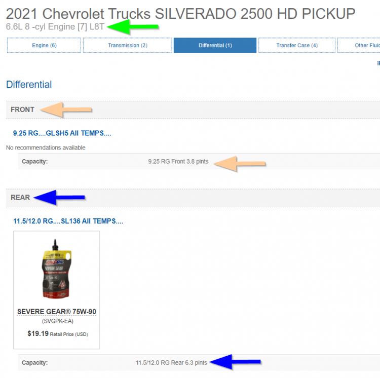

Have a 2021 Silverado 2500HD, the owner's manual does not give info on front and rear differential gear oil capacity nor weight of oil needed. Anybody know?
This Amsoil site has always provided accurate information for both type and capacities.  Not sure if you have the gas or diesel but the below screen shot is for the gasser.  Both axles use 75W-90 and you can see the arrows that show how much.  The link to the site is farther down.  Hope this helps.
https://www.amsoil.com/lookup/auto-and-light-truck/2021/chevrolet-trucks/silverado-2500-hd-pickup/6-6l-8-cyl-engine-code-7-l8t-7/?volume=us-volume
