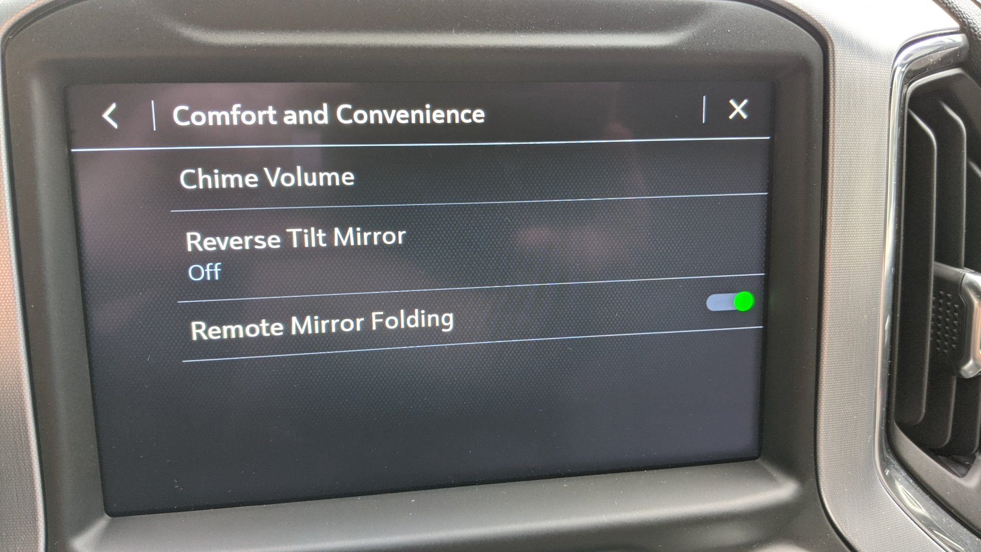

My issue is they will will power fold in,聽 but wont do it automatically when turning the car off.聽
In your settings you can turn on auto fold that will fold in the mirrors when you press and(hold) the lock button for a few seconds. They will also unfold when you press and hold the unlock button.聽
think I will be looking for that again,聽 as I didnt see it at first when I looked,聽 you know where?聽 That would be an improvement.聽 Be better if the setting was for car on and off.聽
Settings >vehicle >comfort and convenience.聽
22 hours ago, nards444 said:
ahh聽 I had that set and nothing happened.聽 guess I will try holding it down
Well, did it work after you tried holding the remote button down?聽 I may have to change that setting on mine too.聽 Will they auto deploy when the truck it unlocked or started?聽 Or do you have to press and hold the remote or press the button on the door to make them fold back out?
You will have to press and hold the remote or press the button on the door to make them fold back out.聽
