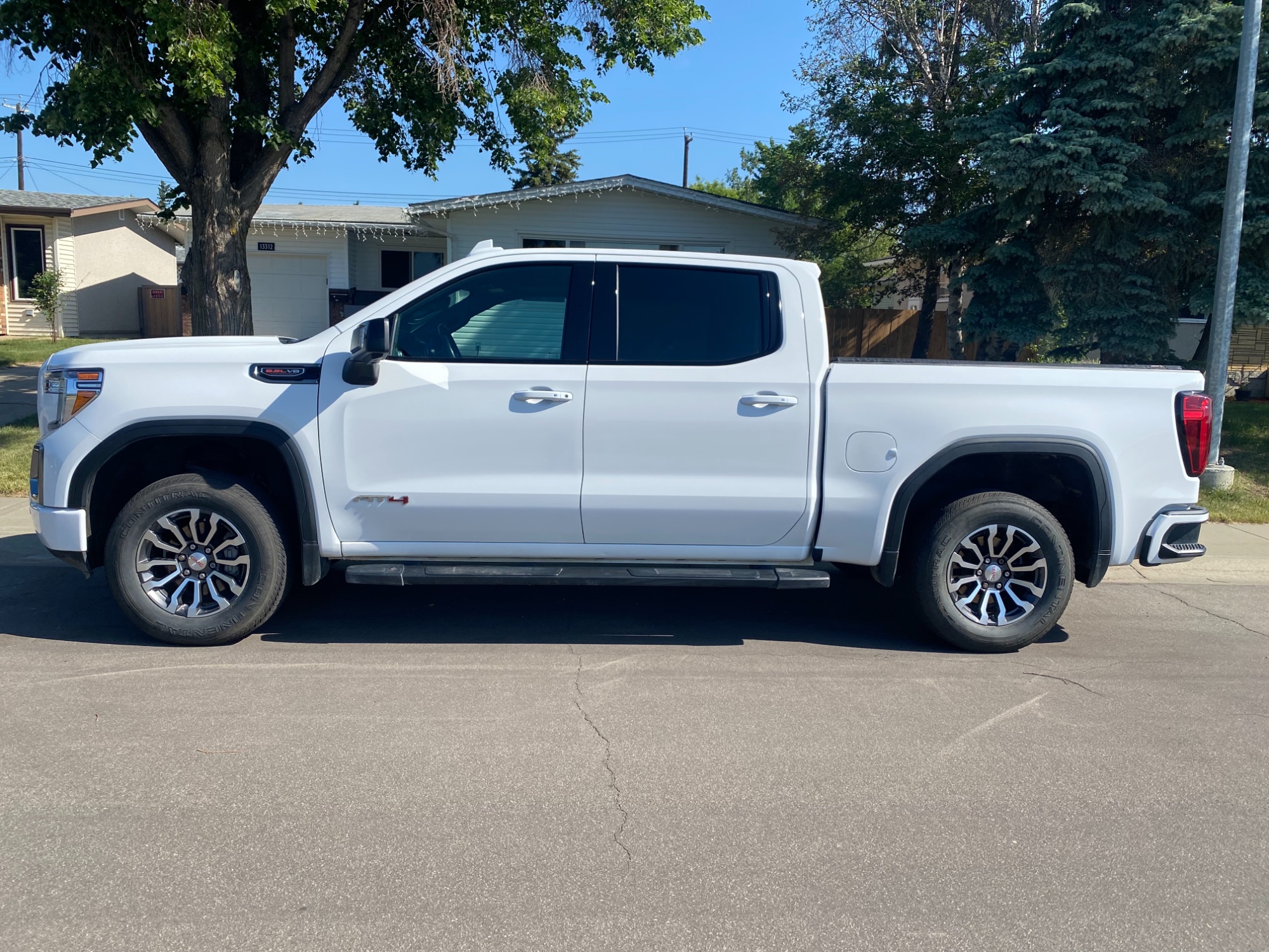

I have a 2019 sierra at4 that I am removing the lift kit and lowering for multiple reasons, main one being my back injury and sciatic nerve constantly going crazy, which makes it hard to get in and out of the truck. I already removed the rear blocks, currently still have the rancho shocks still installed. I have bilstein 5100 front and back shocks/struts ordered for a base sierra, currently on back order until the end of the month. Talking to the custom department at the dealership about drop shackles to level the truck out once fully lowered, he mentioned ill most likely need shims because of a driveline vibration because im dropping that low. Didnt have time to fully discuss it so im wonder what shims and where do they get installed?

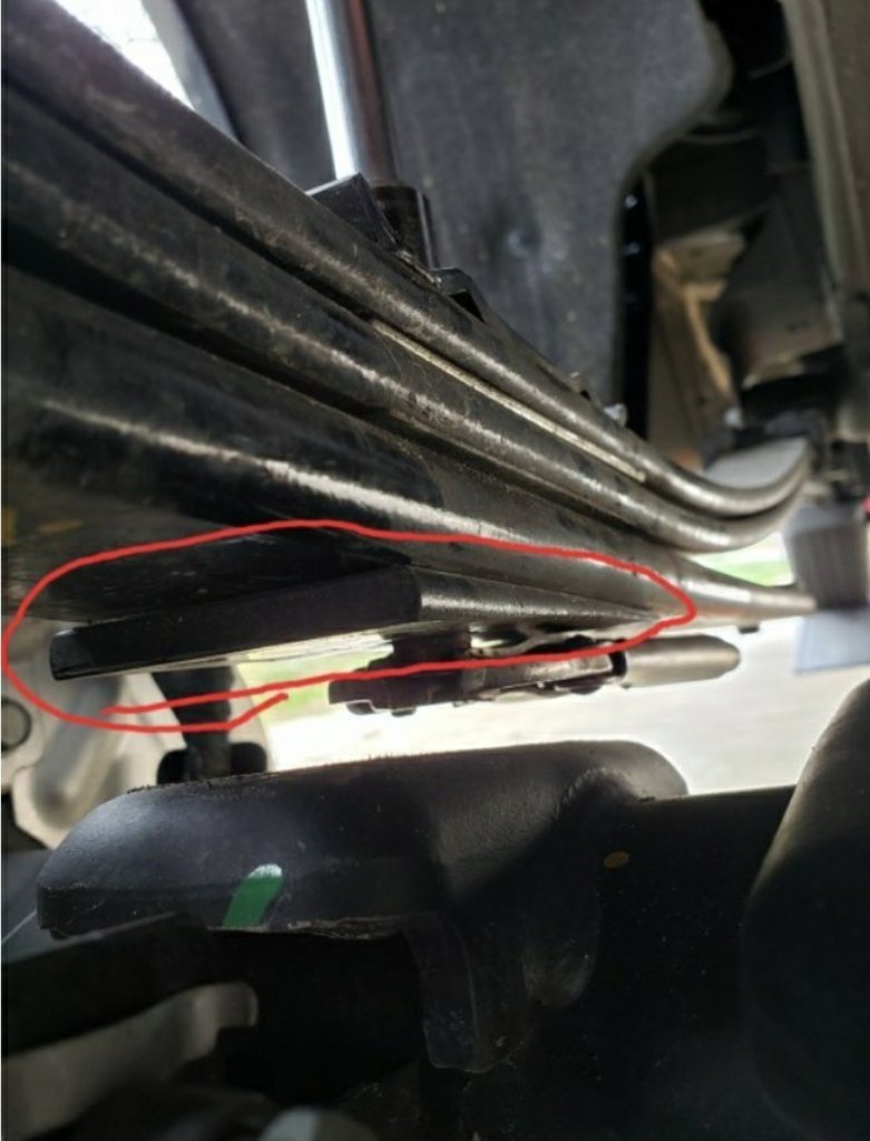

26 minutes ago, mafd2 said:
If you're just using drop shackles in the rear, you don't need shims. Just spin the existing shim 180° and that gives you the correct angle.
I havent messed with leaf springs before. Where are said shims?
That thread is for lift blocks and not lowering and shims. Here's a pic of the shim (vice grips shown attached to the lower tie bolt and socket on the top). I have the 2" Wulff shackles on my 19 RST. There's a drop shackle thread on here. I'll find it when I have a chance.

I understand. Lift blocks do require an opposite pinion angle than lowering. My '19 RST didn't have any blocks and only a shim. I don't think the 4X4 has a factory shim.

That picture is w/o the rear blocks then?
How much lower are you wanting to go?
Yea that picture is without blocks but still with the rancho shocks.  2” drop front and i guess 4” drop in the rear as long as it doesnt cause any issues
