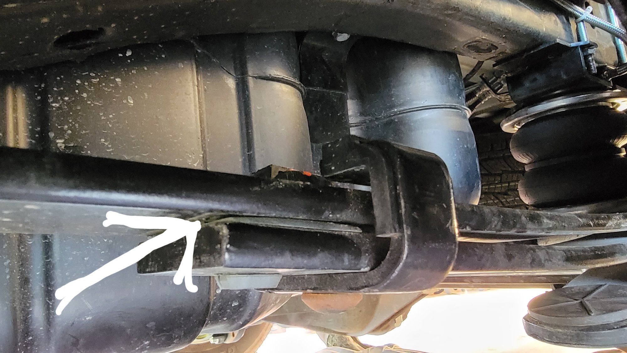

I have a new 2021 Sierra 1500 3.0L that did not have the max trailering package. I was disappointed in the suspension and decided to add airlift 5000 airbags. Once they were installed I noticed something very noisy when going at slow speeds and making turns or any point where one side of the rear was at higher ground than the other.

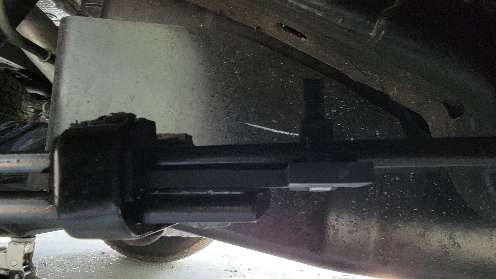

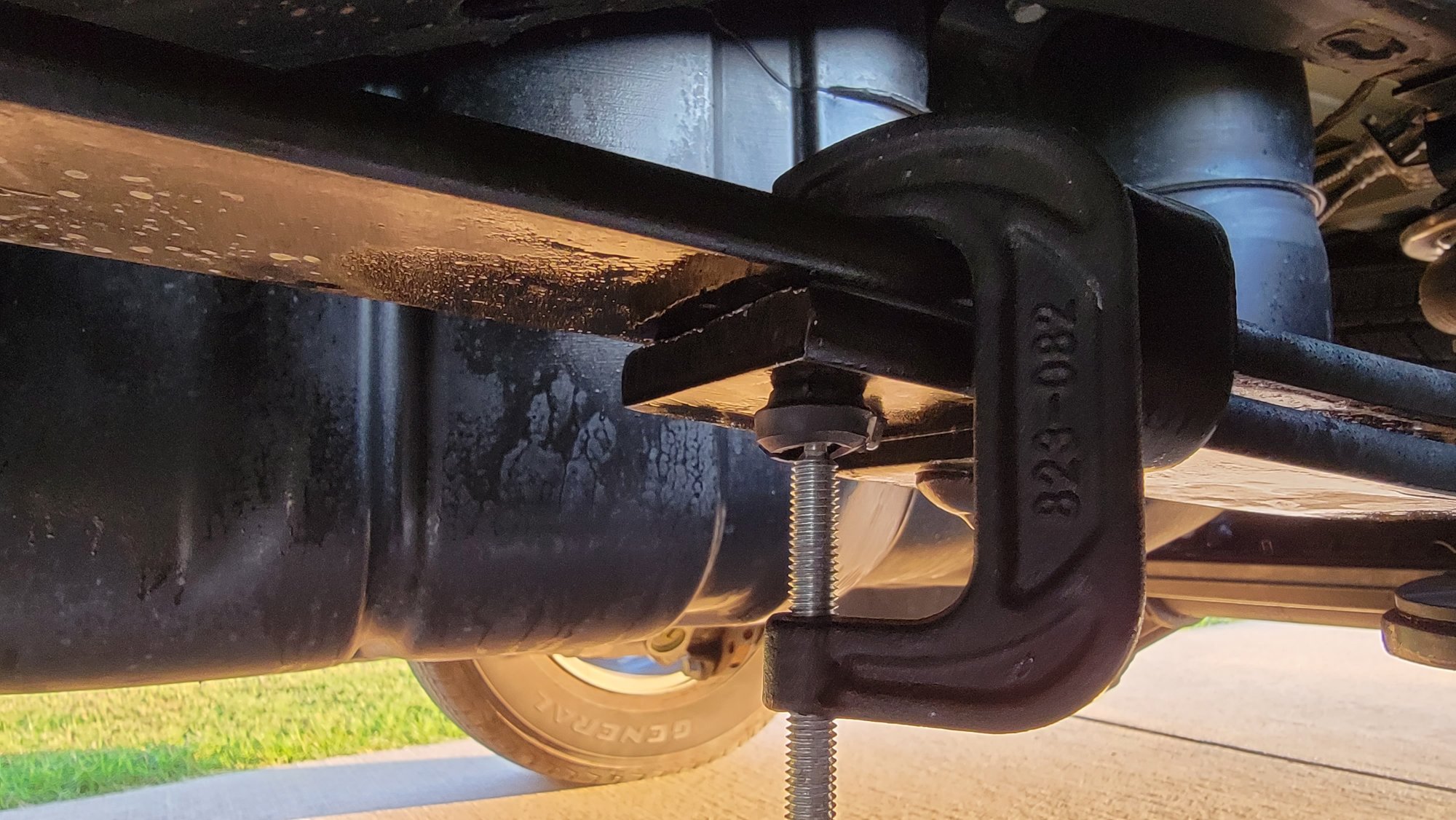

I narrowed them down to the leaf springs when they slide side to side. It appears the rubber or whatever that thing is between them makes a TON of noise. I decided to try to clamo them down as hard and possible and the noise died down a lot but not completely (couldn't prevent them from moving totally)
How can I fix this? I didn't notice it before the air bags so my assumption is the bags took weight off the springs and that's the issue
