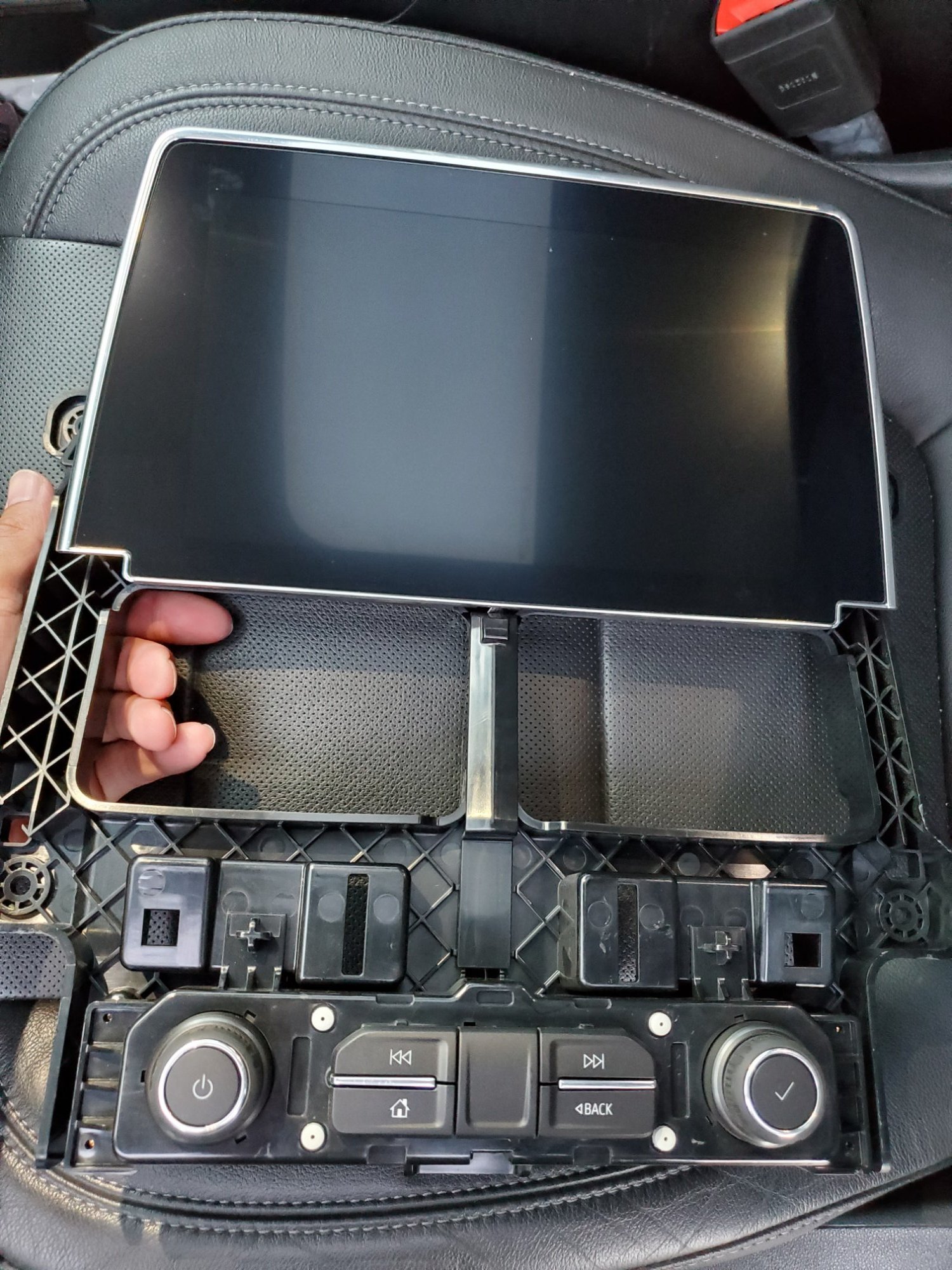

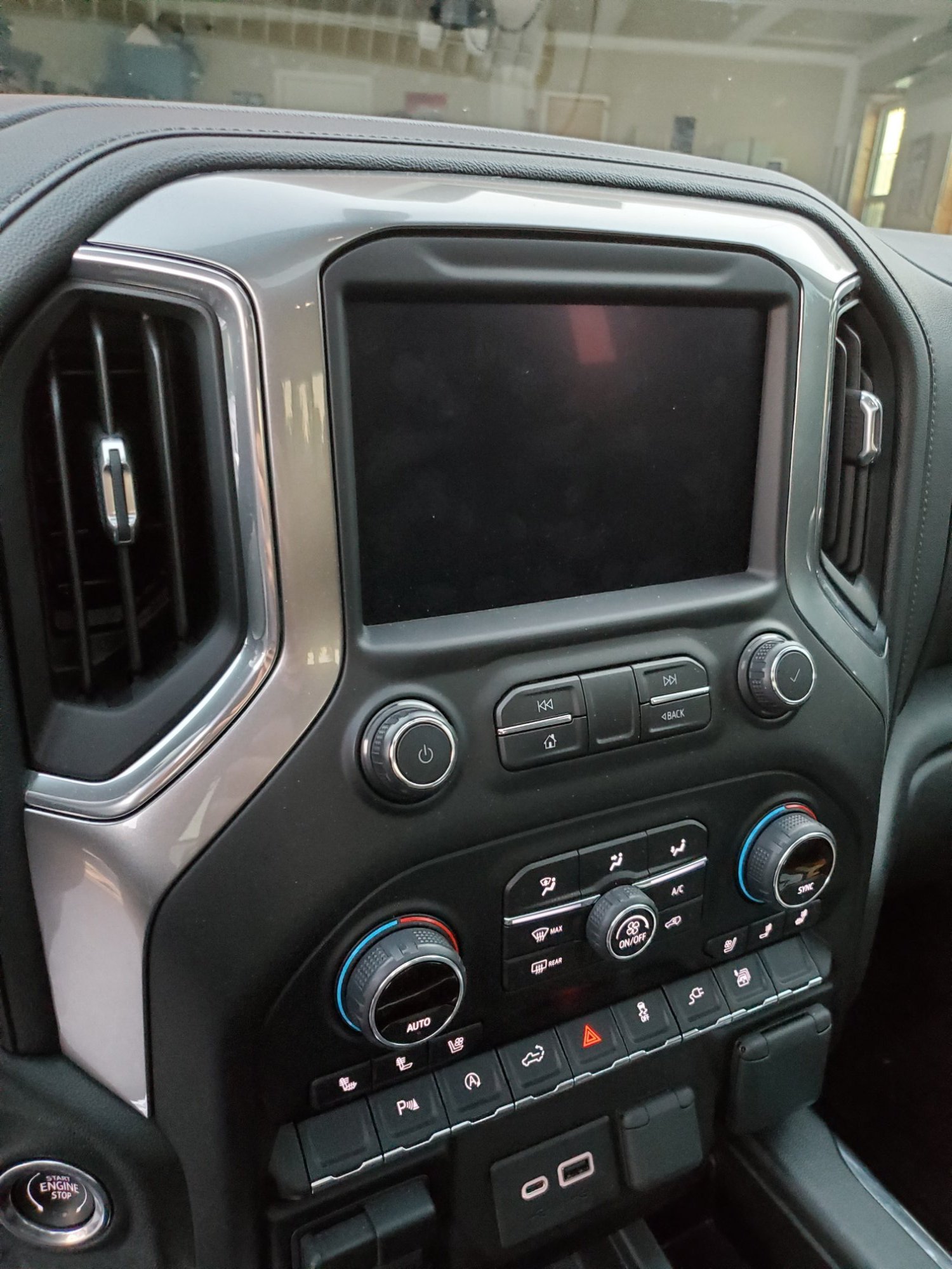

I have been thinking about putting a bigger screen in my 2020 silverado.  I bought a used 10inch screen from a Tahoe.  The connections on the back are the same. I thought I would try it out.
Today I plugged in and the image displayed but it was showing 6 screens!  I know nothing about vidro screens but I do like to experiment.  Touch screen did work.
Can anyone or does anyone know someone who can come up with a way to fix?  Is there a way to convert image or program something? Or I wonder if a Tahoe radio receiver could be installed?
A complete wild a$$ guess, but I assume the actual controller is set to a specific resolution and it fails over the rest of the screen due to the greater resolution. This is a complete guess and someone more technical than I can point out my inaccuracies.

I had WAMS working on this.   Thank you WAMS! WAMS really is the best.  The tahoe screen was built for global B electrical architecture so it was not possible. We may try something else with a global A cars screen.
