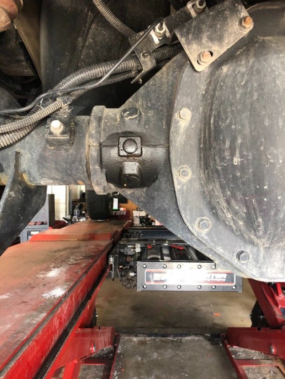

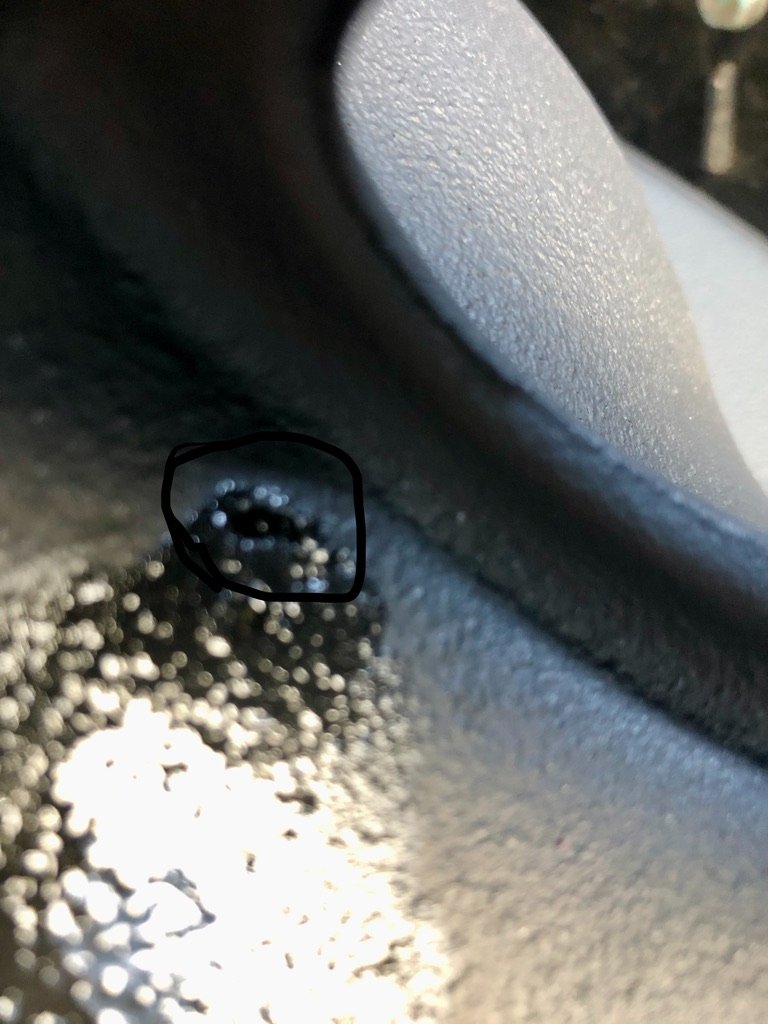

i take the truck, drive 2 miles down the road to the store. I come out from the store and notice what appears to be a leak under the rear differential. I thought maybe it was there from another car, so I look.
The damn new rear differential housing has a hole in it and is leaking oil 😳😡. I cannot believe it. It looks like a casting flaw where there is not any metal there (looks porous).
Immediately I head back to the dealer. The service writer, service manager, tech who did the repair, and another tech have a look. They are all dumbfounded and cannot believe it. The tech who did the repair said he drove it several miles and checked it out and it was fine. I even checked it out before I took the truck and did not see any leak or problem.
So now they are trying to figure out what to do. The service manger was calling TAC and was going to get back to me. Haven't heard yet what the plan of attack it going to be.
I don't know what to do at this point.
I cannot believe that I have had 2 factory defect axles on the same truck. what are the odds??
1st pic shows the leak from new diff, 2nd shows the original leak
