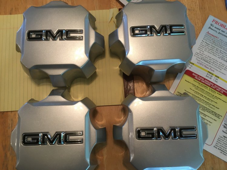

Just ordered this Amazon.com: Dupli-Color EHWP10800 High-Performance Wheel Coating Gloss Black: Automotive    a couple days ago to try.  We'll see how it works.

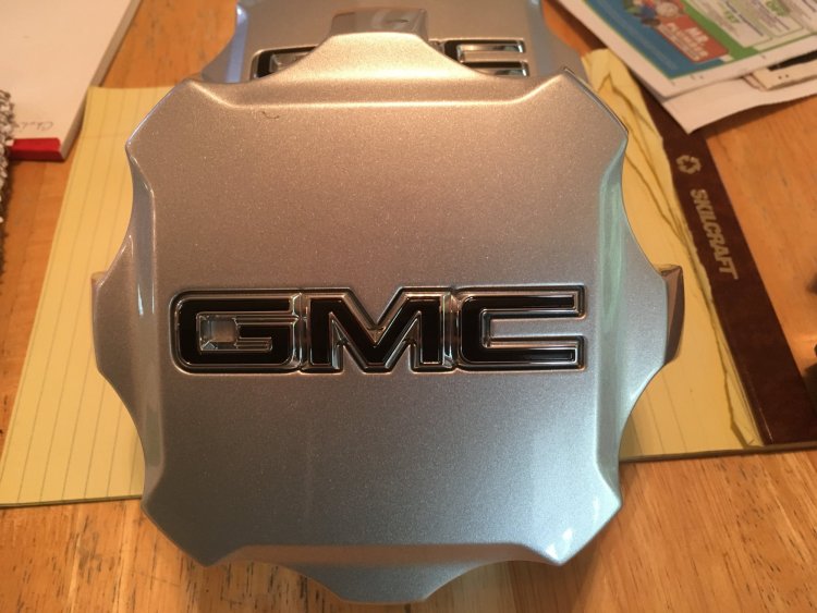

Will have to wait and see how it holds up.  It said good for wheels and plastic.  Was able to get a pretty good prep so I have high hopes.  I think they look pretty good and I never did a clearcoat over the Duplicolor.
Prepped, Drying, Installed in center caps

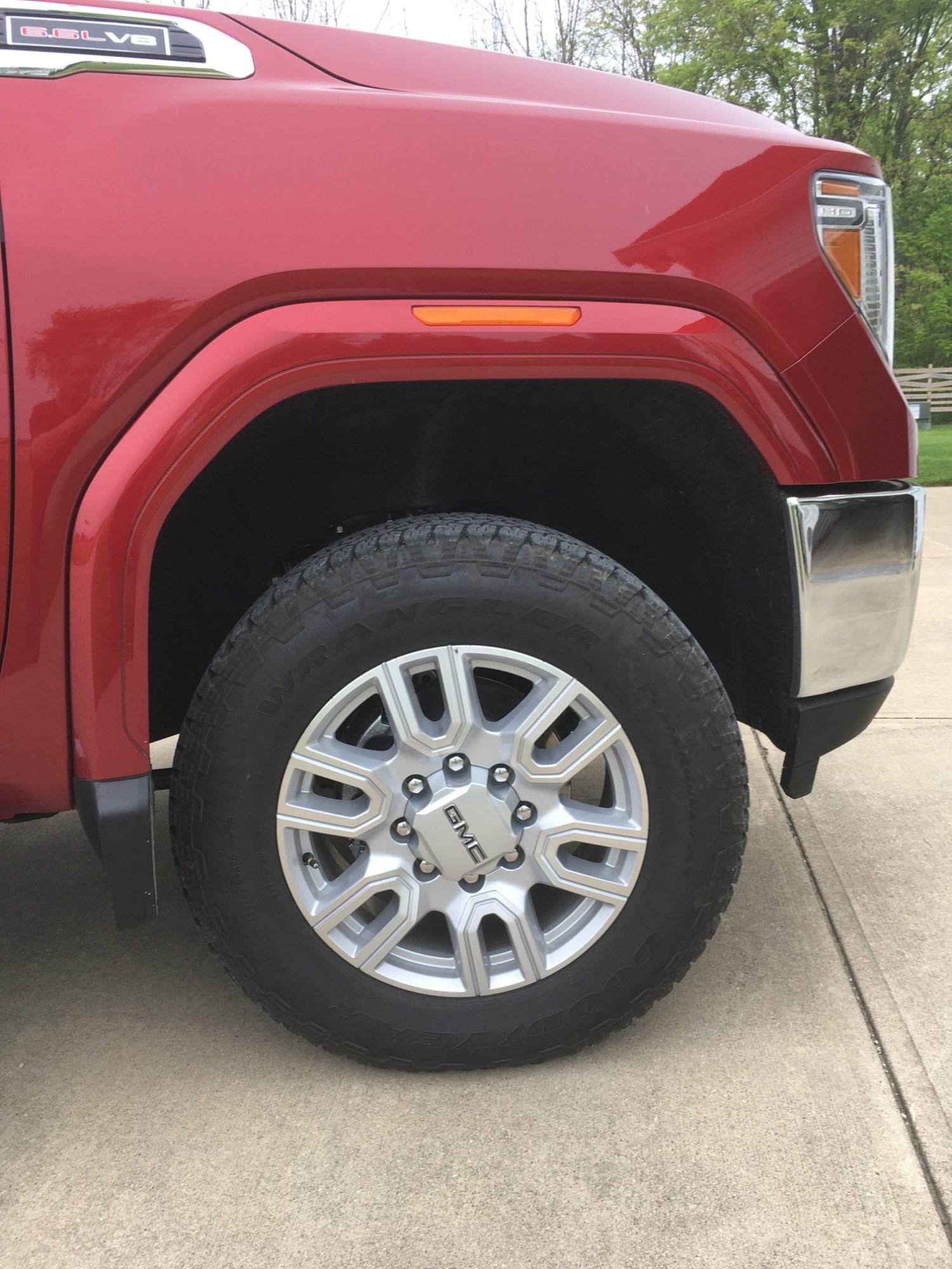

On the truck.  Now the wheels match the front and tailgate emblems.  I just thought the two reds clashed.
I will try to report back if I have any problems.
That looks great and is exactly what I am looking for. Did those letters just pop out of the chrome surround? I'm curious if I can get the gold bowtie to pop out......

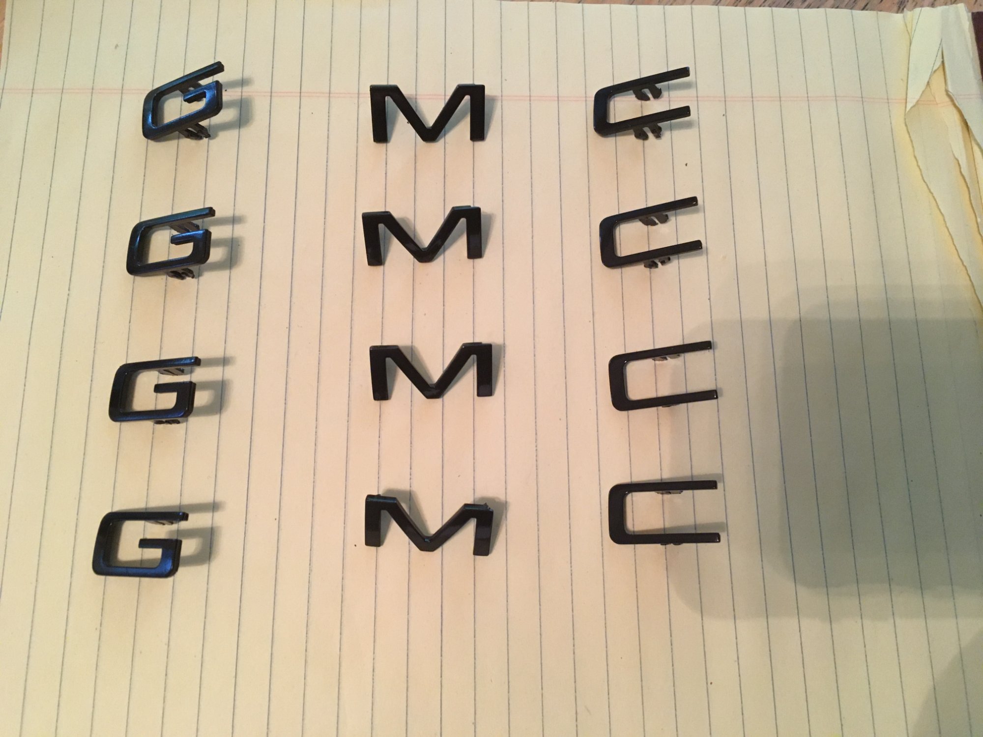

The chrome surround is held on with some 'snap tabs'.  The letters are held on with their own snap tabs, 2 per letter, that go through the chrome surround and into the cap itself.  Neither seemed to have any adhesives.  The letters could be removed without removing the chrome surround.
I just popped the caps off the wheels and very carefully pushed the letters off while squeezing the snap tabs with some small needlenose from the back.  I did not pry on the letters from the front.  Was able to get them all off and and back on without a single break.
