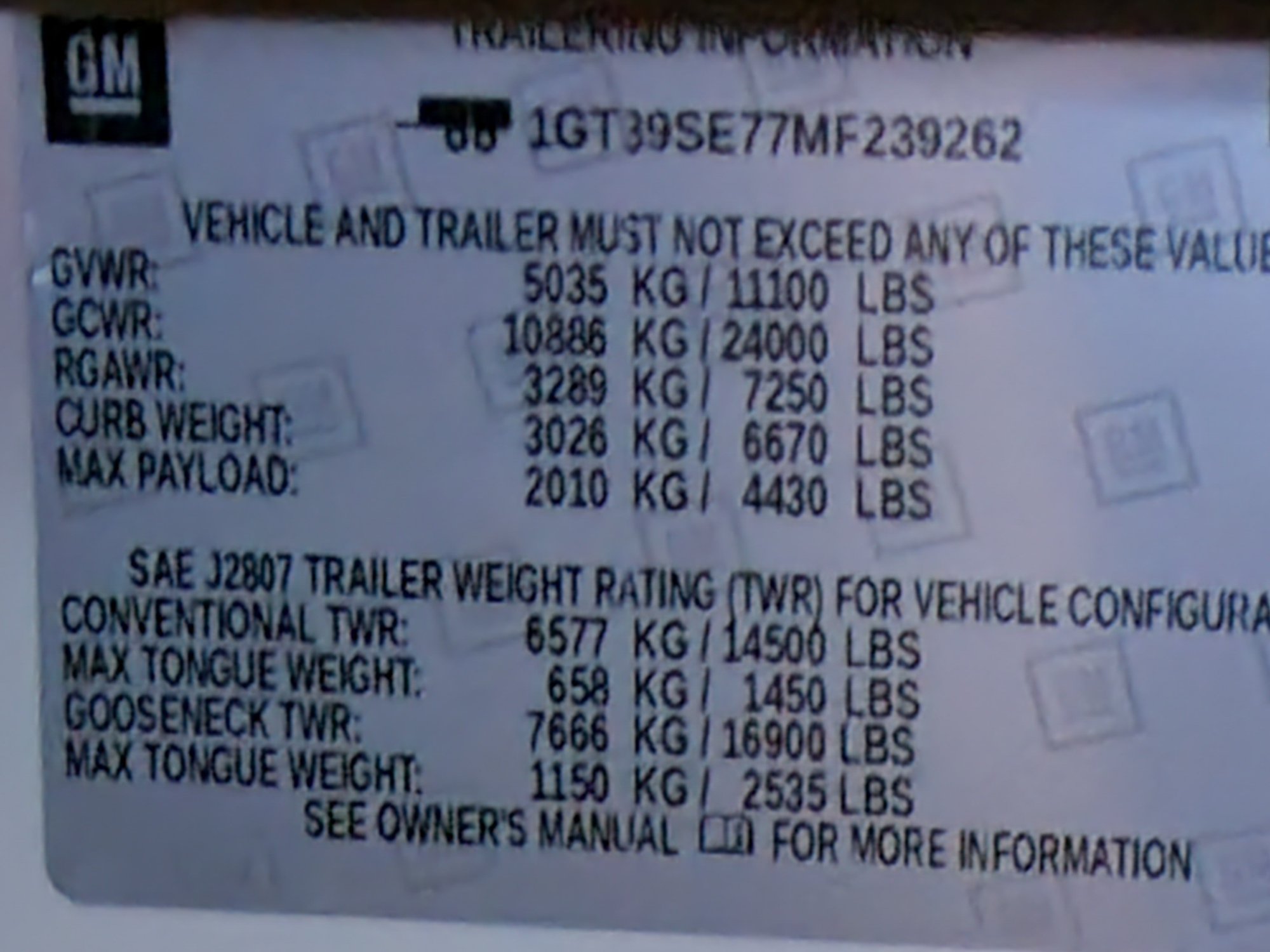

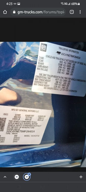

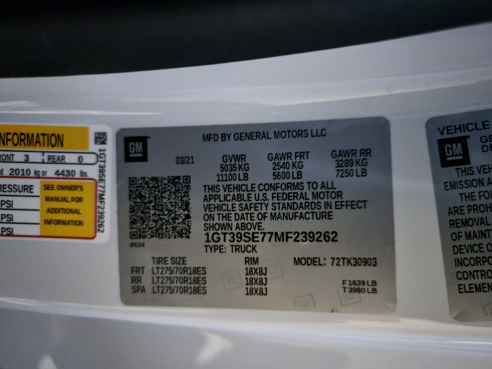

6 hours ago, Zani Koxha said:
A 2500hd CC SRW LT Gas weights in at 7161 I kbow your 3500hd is slightly heavier let's just say it weighs the same the gvw on a 3500hd gas is 11,100 lbs minus 7161 gives you a 3939 payload capacity that's based in the weight on a Chevy 2500hd CC SRW LT Gas yoyrs should be around 37-3800
^^Hey that's me!
8 hours ago, Zani Koxha said:
Show me your sticker I highly doubt that I could be wrong but I highly doubt that I got a 2021 GMC sierra 3500hd regular cab 8ft bed srw 4x4 sle 6.6l gas with camper springs20210726_204534.thumb.jpg.4ae4b9e04b835609fd7ddbb23b8fca06.jpg and I'm pushing 4430 payload I highly doubt the crew cab is only 376lbs heavier the diesel in your configuration weighs 8200lbs+
Why would I lie?
