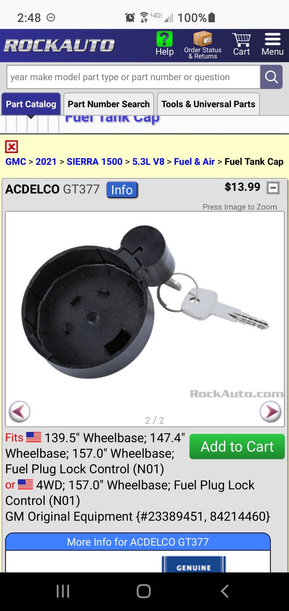

I bought the locking one myself just to keep dirt and water out. And if GM is now including a rubber cover, my guess is lots of issues with dirt getting in the tank.

I bought this for my 2018 and it works fine on my 2021.
https://www.homedepot.com/p/Fernco-2-in-PVC-DWV-Flexible-Cap-PQC-102/100372303
I took the clamp off and just use the rubber cap.  Maybe the engineers know what they’re doing, but I like a cap over the opening.
I bought the same thing (from Lowes).  It is a perfect fit.
