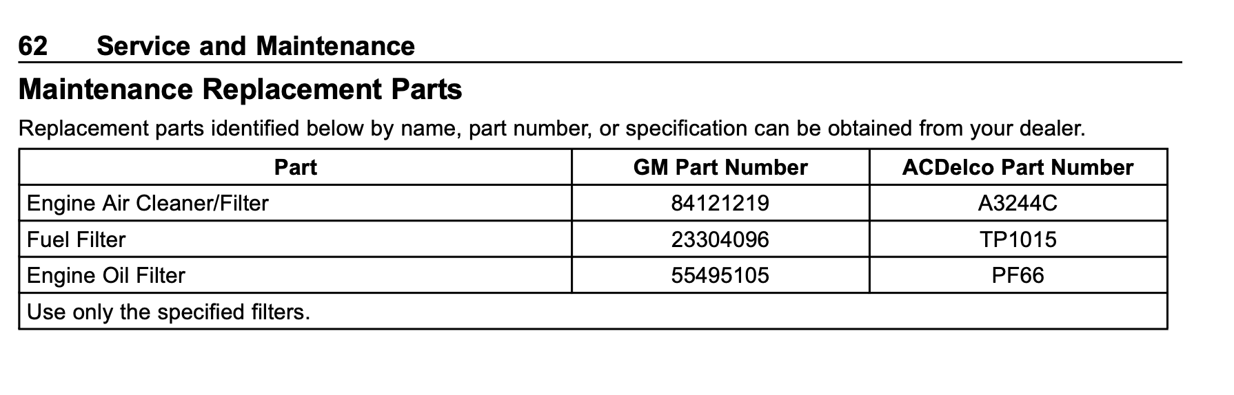

As posted by above, the  LM2 and L5P both use the TP1015
The Fuel Filter Minder determines the amount of filter blockage .
Diesel supplement suggests changing it in the LM2 at the earliest of 30,000 miles, 2 years or when the filter minder recommends it.
Get some dirty fuel and the filter minder will be asking for a change.
L5P the (6.6) diesel supplement recommendation is 22,500 miles or 2 years or when filter minder suggests it.
Presumably the difference in miles reflects the difference in fuel mpg between the 2 engines.
For $15 over a couple years, I'll likely just stick with the TP1015.
