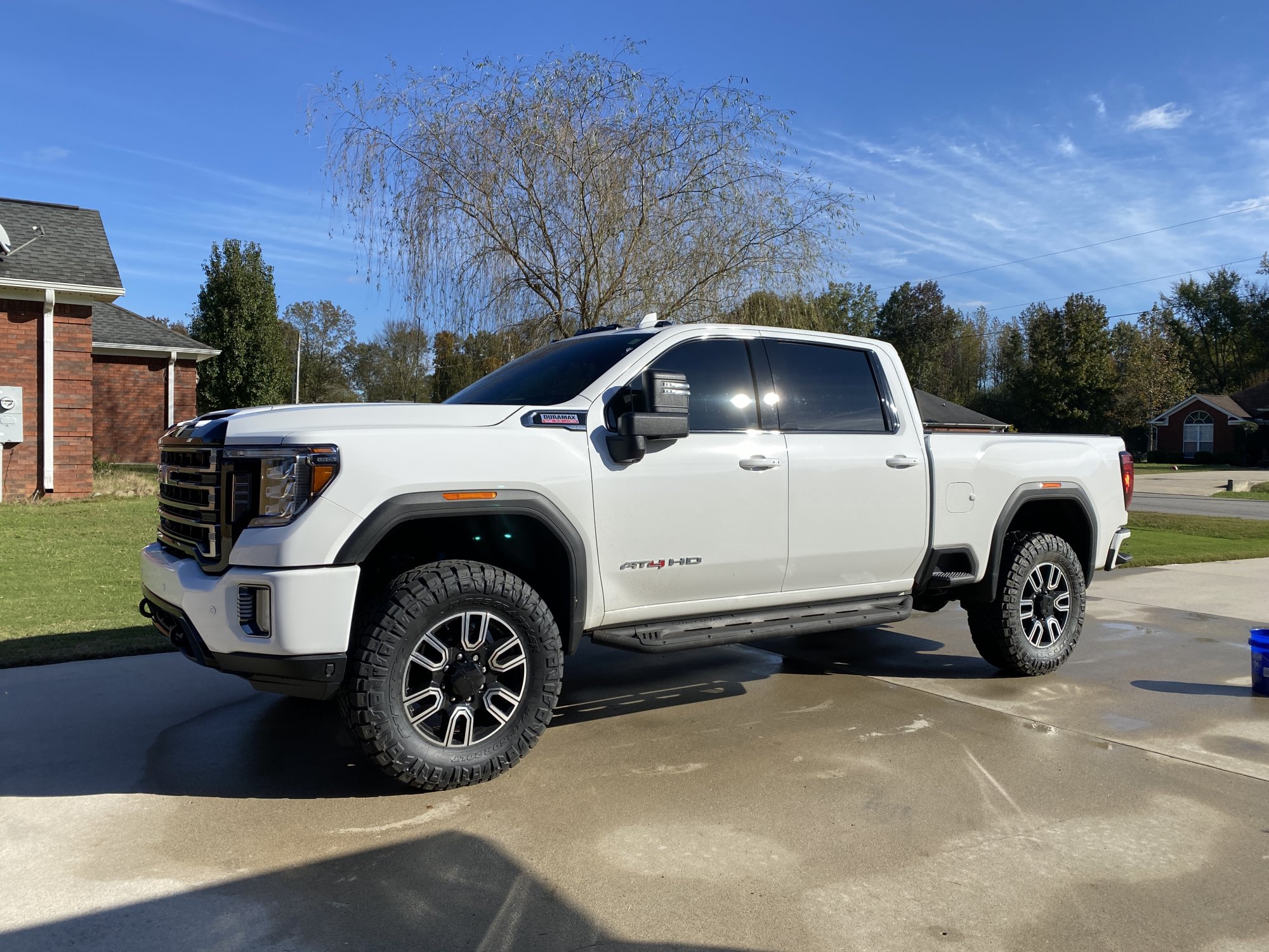

After all is said and done, it will be the Cognito 3” elite level with 2.5 fox resi shocks, 20x9 Fuel Covert in matte black with 37x12.50 ridge grapplers. 5d199b9f7104e6752dddb5dd61ef11d4.jpg
Here is my truck. 3" Cognito Premier leveling kit with 37 12.50's and stock wheels. Had minor trimming on the liners and the mud flaps. The biggest issue is the stock wheels will make contact with the Cognito upper control arms at full lock, so I had to add a 1" wheel spacer and then everything was perfect. I was never a fan of spacers, but as long as its not too big its not bad, the biggest thing is getting a quality spacer that is hubcentric. I had absolutely ZERO vibrations at any speed range
Not sure if the stock wheels would contact the control arms on the RC lift or not. I was told by Cognito that I couldn't run 37's on stock wheels with their kit, but I chose to buy what I wanted and make it work. That may be what you need to do as well.
