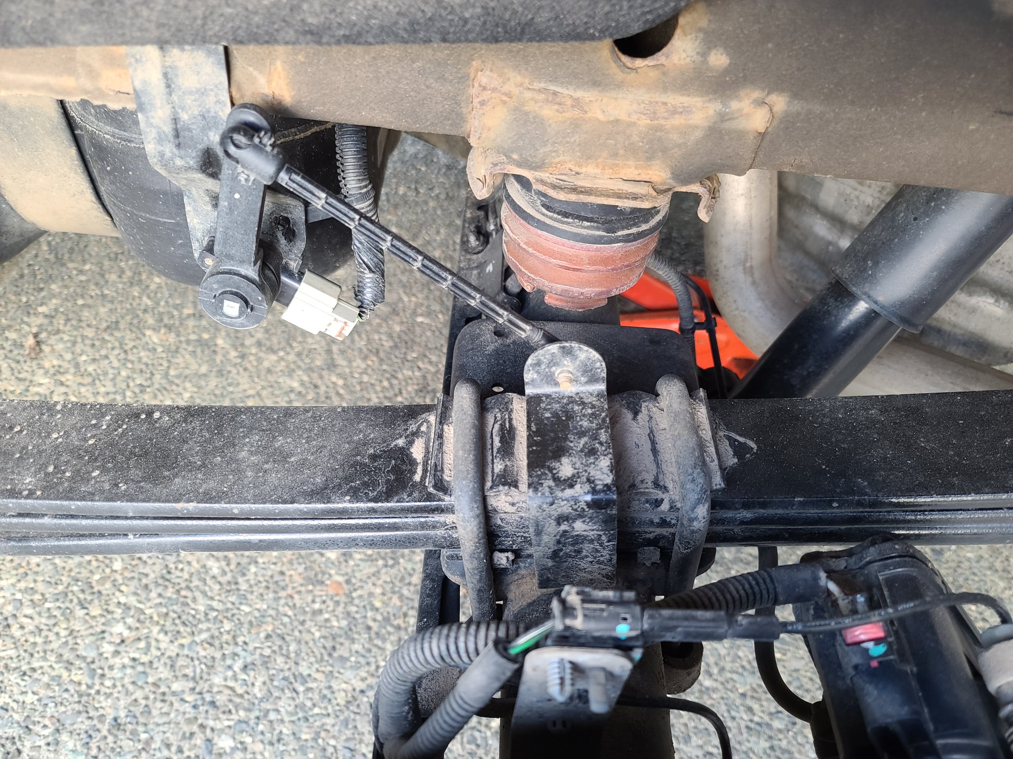

Has anyone installed Supersprings on their 19+ denali with ARC?
Took a wheel off tonight and to my surprise there was a sensor bracket, for ride height im assuming, sitting over the middle of the spring pack
(Im new to gm trucks, only had this truck 2 weeks)
I've been looking for options to handle the tongue weight on this soft as **** rear end, I ordered Supersprings and here we are...   short of disconnecting the rod and bending bracket out of the way... and getting codes.
