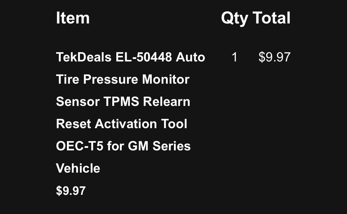

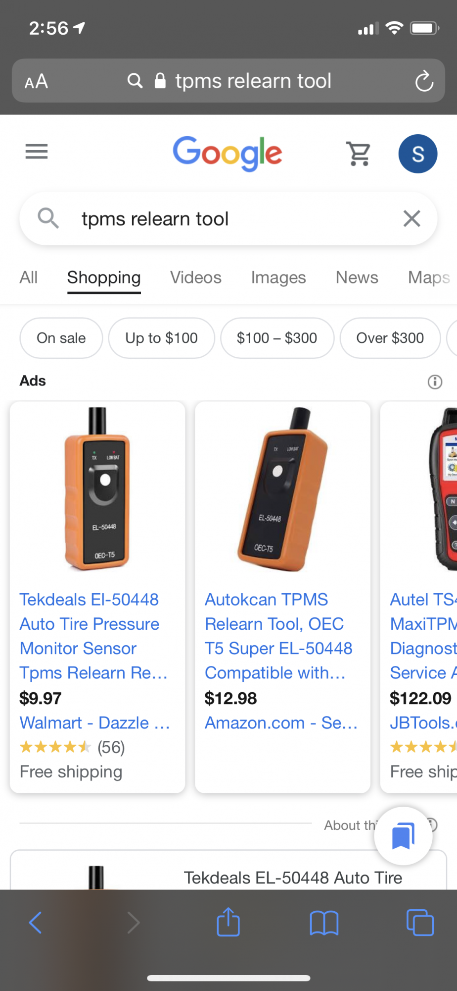

Now can someone explain more about the TPMS relearn? I can’t simply rotate my tires?
I mentioned it above but Walmart has a tool for 9.99$ that has broken English on the text takes a 9v battery and will relearn your sensors after a rotation. It’s in the owners manual on how to do it. I was skeptical but I figured for 9.99 what can go wrong? Worked like a charm.
You can rotate your tires but the pressure readings would not be in the correct locations. So if you don’t mind remembering which tire is where or if you don’t even check your pressure with the computer than it doesn’t really matter.

Do you have a link or picture of this tool?
