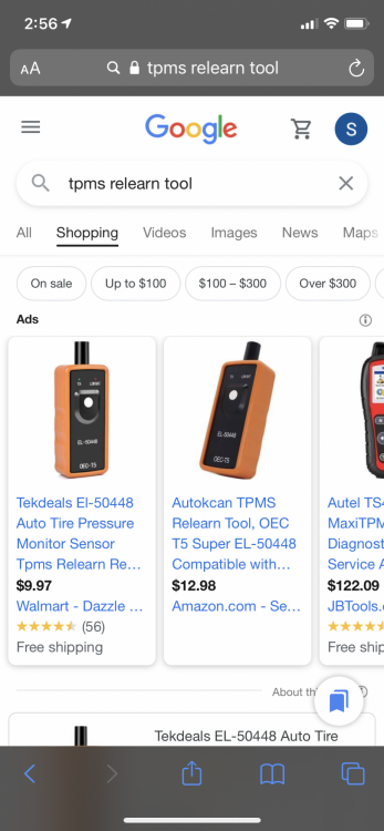

Just did my second oil change at 8000(1 year), dealer did the first at 5k, I switched to Mobil 1 advanced fuel economy because that was the better brand that was available in 0W20. Can’t remember what filter but it definitely wasn’t a cheap one. By the way, rotating 35’s sucks. Oh and if you rotate tires yourself and want a tpms relearn tool, get the 9.99$ special from Walmart, ****** is legit.
Checking on the TPMS relearn tool you mentioned.  Yes, have 35's to rotate as well.  Thanks!

Have been doing my own since. Easy on this tall truck. Now can someone explain more about the TPMS relearn? I can’t simply rotate my tires?
