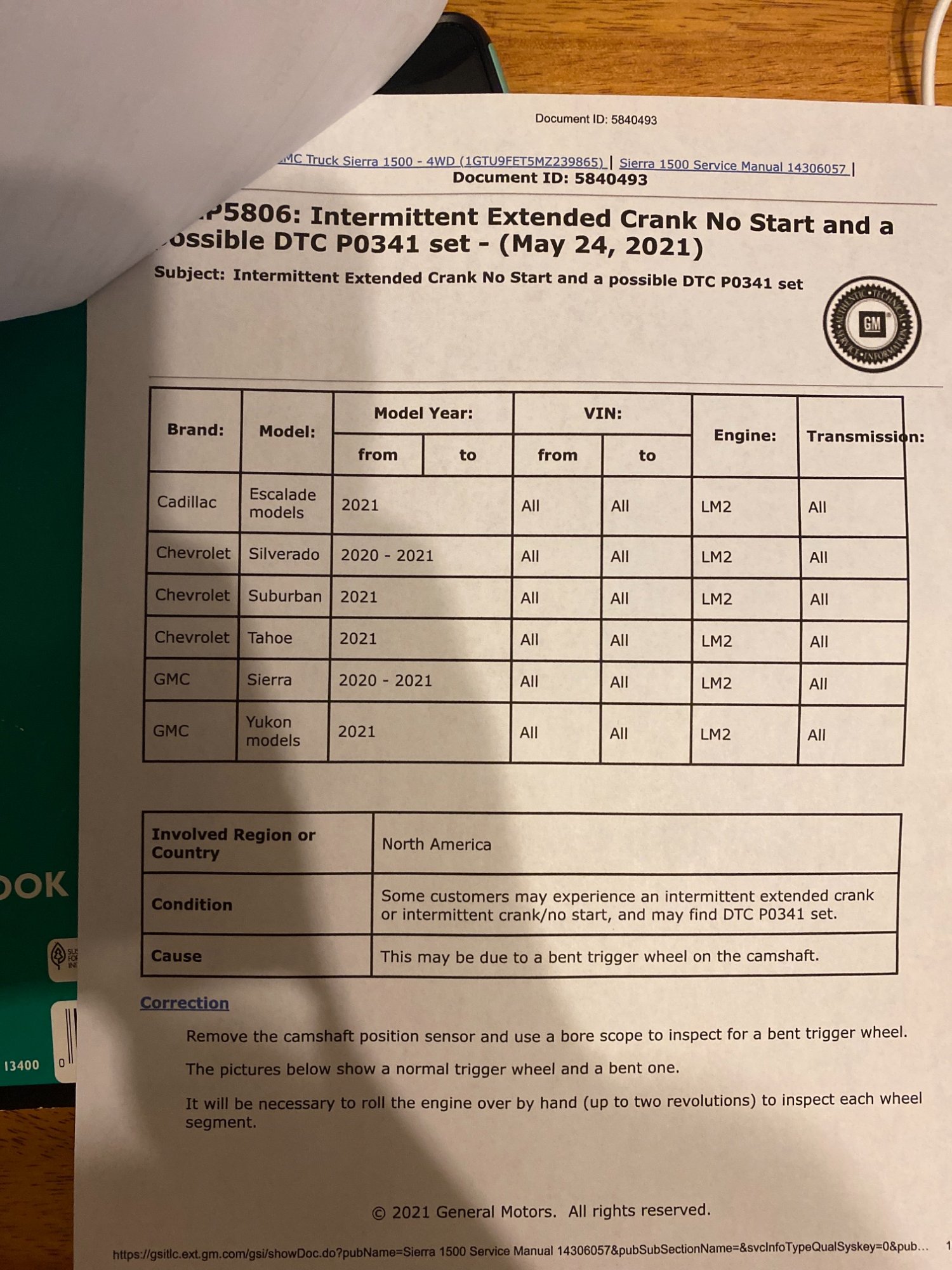

“Bent trigger Wheel” is what GMs bulletin said. I took it to dealership and they searched for bulletins and found that.
I guess I will know next week, when they replace the part( being shipped) whether the trigger wheel is bent or not.

While talking to the Service advisor, I gave him the document ID 5840493 along with a video of the extended crank.
Other link describing the issue: https://gm-techlink.com/?p=14824
He said it looks like the issue I am having.
GM has this repair at 3.1 hours. He mentioned it should be closer to 5 hours.

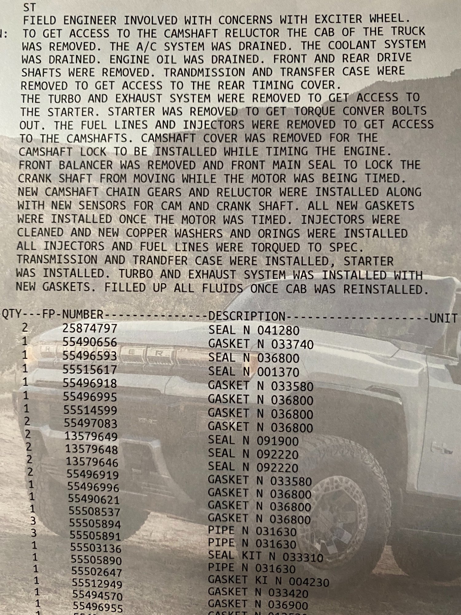

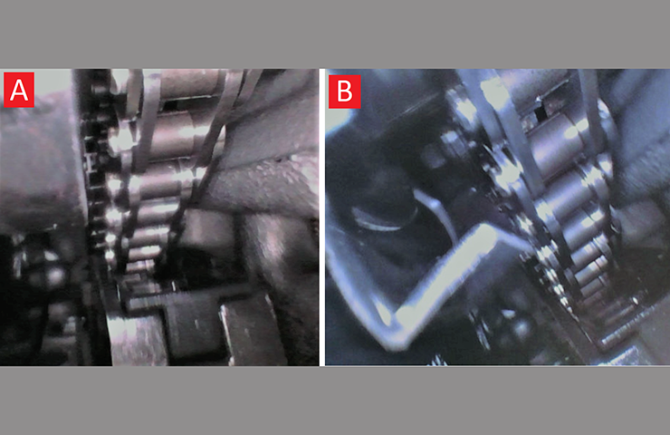

Hey guys I have an update! So dealership finally got everything dialed in. Apparently mine was the first one to find the fix. I have the pictures of the bent timing ring for the camshaft. It’s a pretty big job. Involves removing cab, changing timing gears and chain on top of the ring. I suggest anyone having this issue contact your dealer immediately. If the bent ring is bent enough, it can touch the timing chain causing damage to the chain. Truck runs beautifully for now! Will keep updated in maybe a months time to let you fellas know how it’s going.
Holy ******.... removing the cab??  What's the estimate rework time on this job?  Do they have any way to verify the "cranks but won't start"?  Mines done it 3 times since new (<1500 miles)

Can you please share the photos?
For sure. I’ll try to attach them and not screw this up. The service manager sent me the ring picture. He said he took the picture and the engineers had to come. He said B was my truck and A was a picture from an engineer. Here’s the work order of the work. Sorry it’s not showing more. I’m just to lazy to mark out my info. They didn’t say what the job time would be. I’d imagine a week at least. Just for waiting on parts. Mine took 2 months because apparently I was the first or at least my dealer was the first to figure out the issue. The dealership said GMs bill for that fix is 11 grand. 💀

Wow!  What a bummer, not happy GM has to take the whole truck apart to get this fixed... I guess you just have to pray you have a good tech doing all the work...   I wonder how much work it is to get the camshaft position sensor out??  I'm about to get the bore scope out and give it a try.
