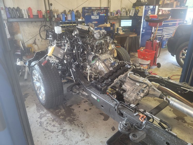

Sorry to hear of your plight. My truck is still in shop  Hopefully it will be out this week after 37 days. Bent camshaft sensor exciter ring and they are also checking fuel pump for a potential secondary problem.

I don't have a picture of the bent exciter wheel but I looked at it and one of its tabs was bent at least 1/2". When they removed the camshaft cover to borescope the sensor, I asked if I could use the vehicle while parts ordered, they informed me that is not a good idea because further engine damage could happen. They don't tear the engine apart unless they find that the sensor exciter wheel is bent. I would suggest that you have the inspection done to confirm.
