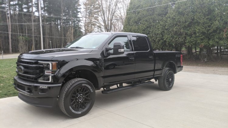

Hummm. A truck can’t tow at maximum limits for extended times without breaking down. I did for 20 years with multiple vehicles for a minimum of 100K miles each. My half tons had max payload from brand new until trade in. My trailers were capable of stopping their load and the truck. Diesels were the primary workhorses. The early gassers were 390s,454s, a couple V-10s. Honestly they all were over max limits. Of course that was until the mid 2000s. Payload and tow loads have increased. I would have been within the new ratings.

My shop see examples of heavy towing daily. Non of my trucks were stock. 0195e6033da8110ef4209a0f2d478081.jpg
