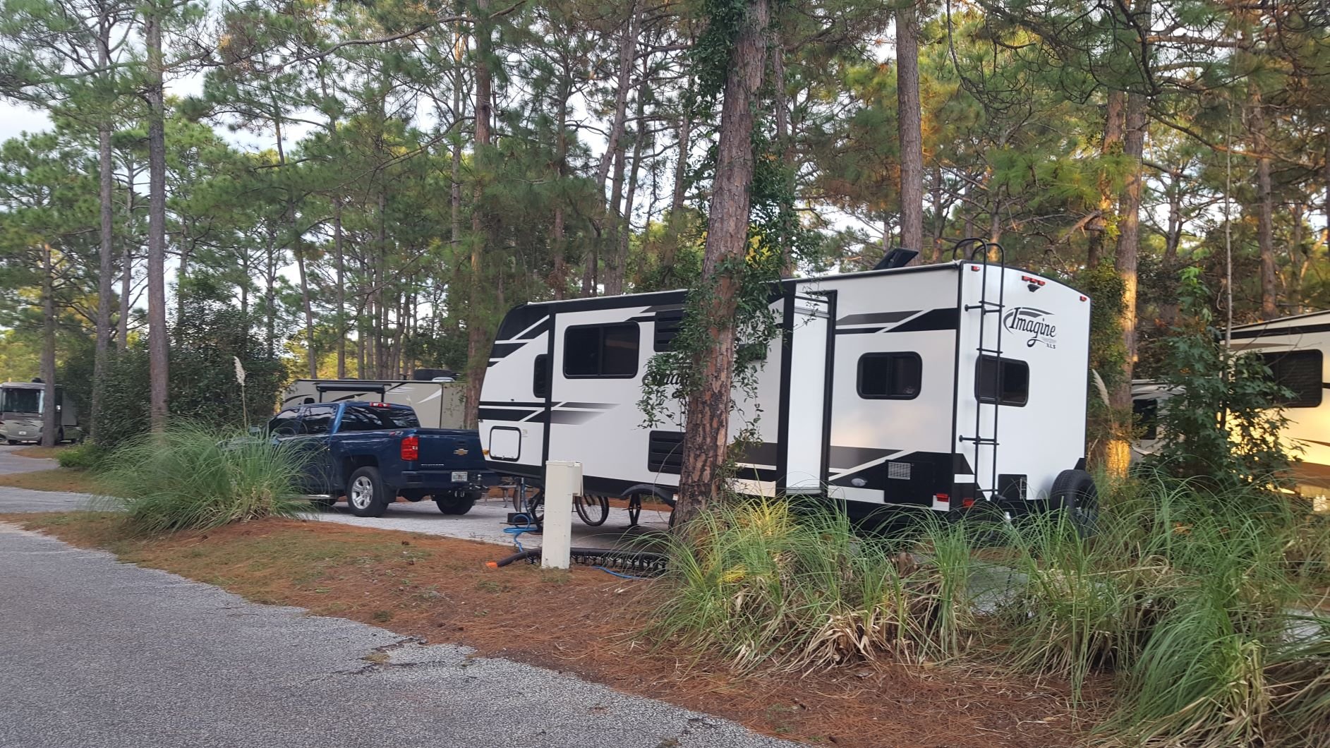

The 5.3 pulls my 22MLE quite well. I did a trans thermo pill flip and changed out the water thermo to a 174 degree. Heading out west next month so I'll see what differences they make.
Nice set up!  What is the length and weight of your camper?  Also what mpg do you get while towing?
P.S.  I forgot to mention in my original post that I also changed to the 174 degree thermostat.
IIRC the 22 is 26'-10" LOA
Last trip she weighed 6458#.
TV loaded with full tank of fuel was 6000#
It tows and handles very nice.
MPG hovers around 7 to 7.5
