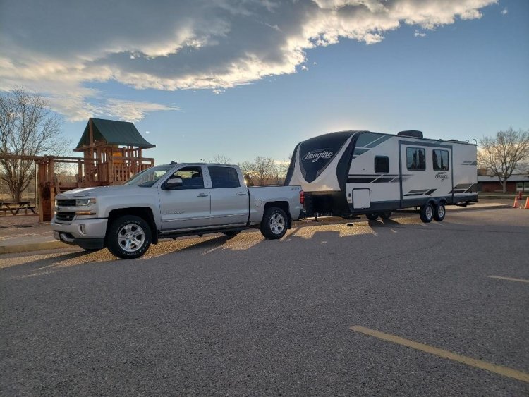

Like everyone else said, it would be easier/better/safer with a bigger truck.  That being said, I tow my 32', 7900 pound (fully loaded) camper with my 2018 Silverado (with the same set up as yours).  The only limit I am close to when I tow is my trucks payload, which is 1662 pounds.
I have made a few modifications to my truck to help it tow better: deleted transmission thermostat, reprogrammed my electric fans, LT tires, rear air bags and GM factory towing mirrors.
I am always towing at high elevations and I never tow over 65 mph.  My truck does fine although my towing mileage is low, 6-8 mpg on average.

I'm fixing to swap my 27ft for a 32ft similar to yours but older. Which WDH are you using and sway control?
I have a 6.2, 8spd though. My 8spd runs pretty cool stock. Highest I have ever seen it is 192 while towing in 105+ heat

I am using an Equalizer Hitch, it is a weight distributing hitch as well as sway control.  I think it does a great job.
My Silverado is only a 5.3 with the 6 speed.  While towing uphill on a long, slow dirt road at 9200 feet above sea level, I saw transmission temps around 220 degrees before I deleted the transmission thermostat.

Is it the dual bar setup? I have the only 2 bar with chains and a separate sway bar and I don't love it, so looking for something better but have read mixed reviews on just about all the hitches.
Yea my uncle would follow me in his 5.3/6spd 2017 , I was towing and usually around 173-180, and he was running 195-200 with no load. So I figured the 8spd just runs cooler

Hey Matt is that a 2600RB ? Looks like my set-up.
