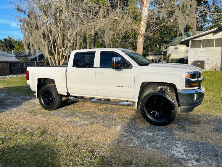

Do you have any pictures of it each way? You using stock ltz rims?
1 hour ago, WSFD6107 said:
35x12.5x20. Just soo you get an idea of the looks
Looks great, what lift are you running. Also does anyone know if you really need the .25 spacers with factory Ltz rims with their 3.5 lift?
