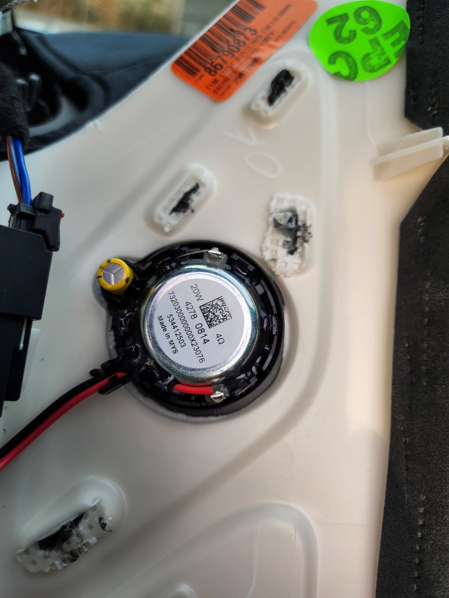

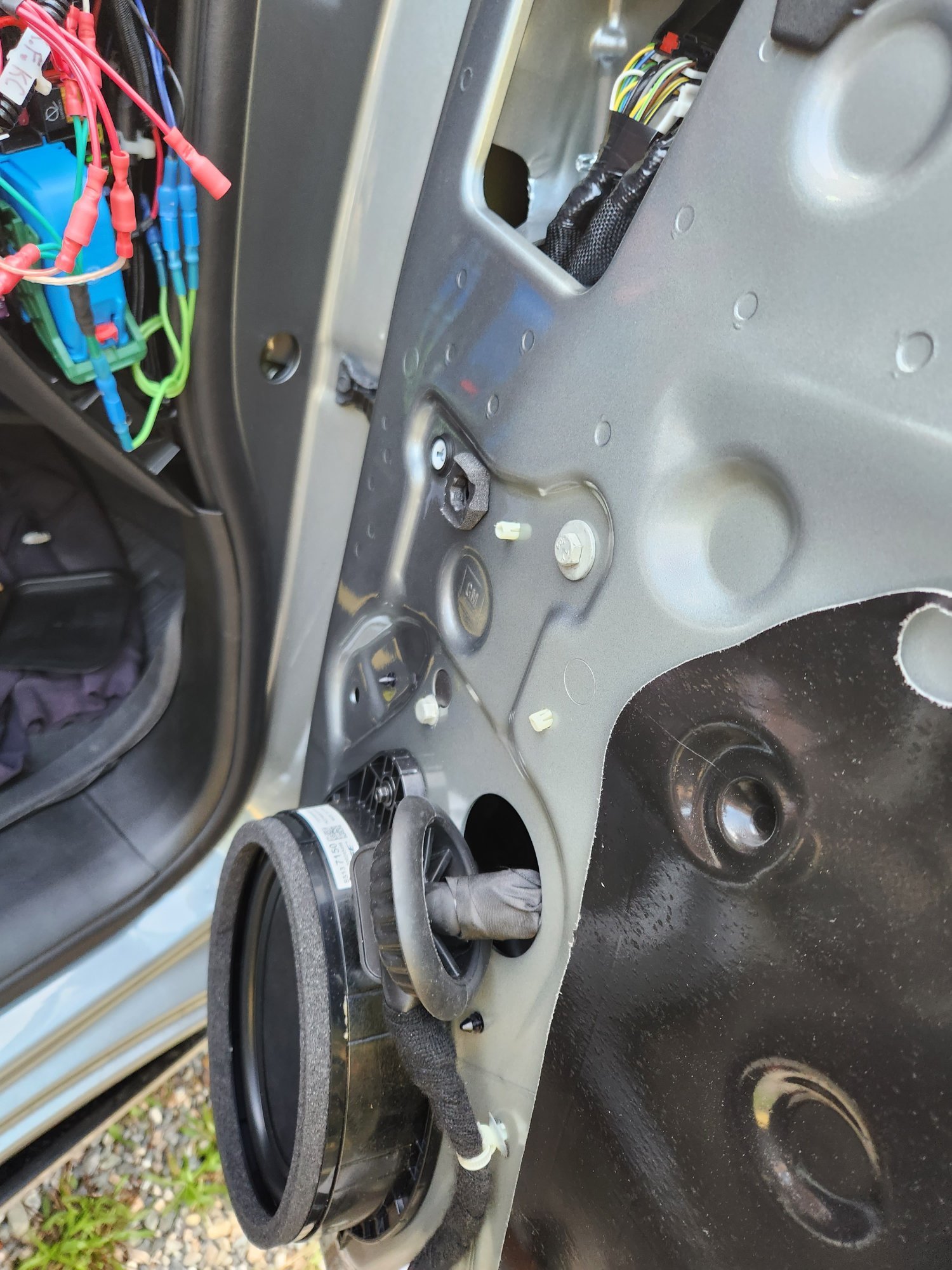

Do NOT Fear the Door Panel Removal.  Some good You-Tube from GM owner "Don's Life", and others,  posted on GM-Trucks as well.  Pix of My door removed on pass. side and "A" pillar driver side removed.
MY FEAR...is how to get the Denali '24 Dash top pad off, to replace the "Corner Speakers". These are 2-3/4" dia. paper cone speakers. One GMC owner , replaced them with Pioneer, # TS-A709, 2-Way with tweeters, and said an excellent improvement. I have these on order. Replacing the "A" Pillar tweeters tomorrow, with Kicker # 46CST204's. A Titanium Dome tweeter, vs. the stock Cloth Dome. Kicker's Will be brighter / crisper , with a metal dome vs. fabric. None of these OEM speakers have the "Bose " name on the speaker frame or magnet. China speakers , with Bose Name on the Grill Cover, and Marketing/ Hype $$ on the build sheet.    "SMOKE AND MIRRORS" Advertising.
