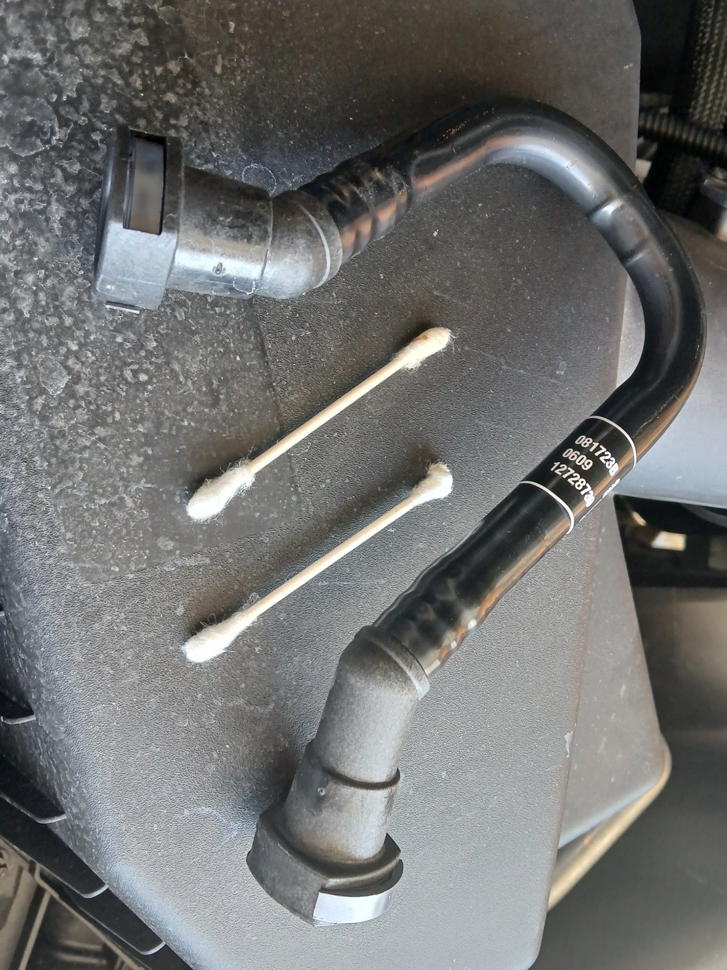

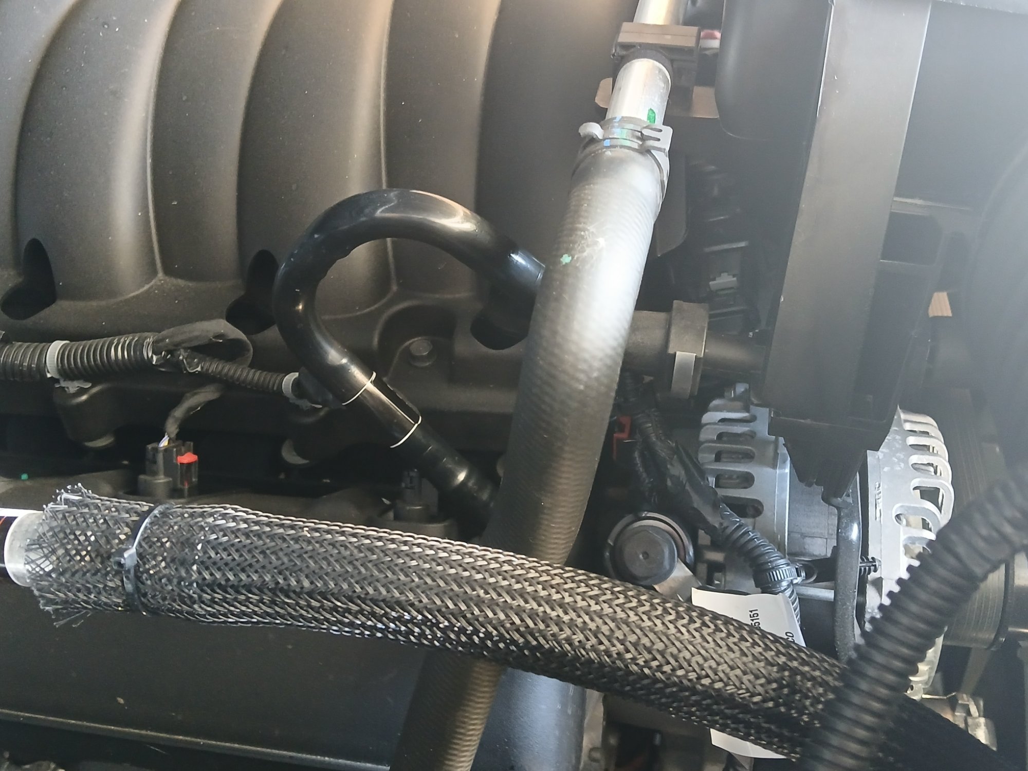

OK, so as mentioned, this is ( just ) and experiment for me. This added, will be all i have till it fully warms up hear and or when i try non ethanol fuel at 87 octane. A full tank full when i stumble across it hear in the northern midwest.
For the heck of it, yesterday i went to install a added catch can on the passengers side. In all ( there ) wisdom, the connectors and plastic hose isnt the same as the drivers side. So no can installation.
... Today, i took a couple Q-tips and went for a look into iffff, anything did or does go between the passengers side front valve cover and the intake.
... As of about 5,700 miles on my 2024 L8T,,, nothing.
Every one likes pics. the first pic is the plastic pipe that goes between the intake and passengers side valve cover. Next pic is the 2 ports or spots it plugs into. Next pic is it and 2 Q-tips i swabbed the intake and valve cover as well as the pipe, as far as i could with the said Q-tips. Nothing.
... The same 44 mile trip today with an empty can, on the drivers side,,,  resulted in about a teaspoon of oily water vs the other times about 1.5 tablespoons. It was 50-55 today vs the other times 20-30, so seems temp plays a part in the can.

Seems your truck is running as intended.
if you start swabbing inside your exhaust you will probably get some soot residue in there. Doesn’t mean anything.
internal combustion engines are messy.
