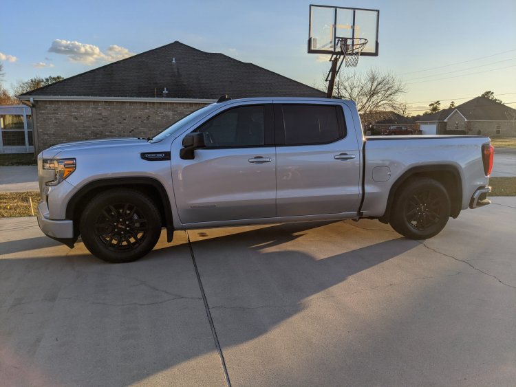

So here is my 2020 Elevation I just lowered with 2/4 Maxtrac drop kit. For those of you that have lowered your trucks with a flip kit, how does your truck ride? What shocks did you use? Any vibration issues?
  • Thanks 1
Looks good. Are you having any issues with your setup? Is the rear a flip kit as well? When I was looking I was only able to find 2" shackle and 5" flip rear drops and I wanted something in between. I settled for 2" shackles and 1" lift in front to level mine out. Now your pic has got me "thinking" again. Did you take measurements before and after?
I had some vibration because my truck did not have the 2 degree shims from the factory. I located some and installed them yesterday and it improved quite a bit, but there is still some vibration at 60mph+. My kit came with 2 transmission spacers with the recommendation to install the thicker of the 2. I am probably going to put the thinner one in and see if that works.
And no, I forgot to measure my truck before I dropped it. But, here is a before pic...
Wow that looks great. I was one of those guys that got an AT4 because of the lack chrome and the features, really didn't care to have the lift. The Elevation was what I wanted looks wise, and this subtle drop really sets it off.
Mine sat like yours stock and after the 2" drop shackles, was just not enough for me but I live with it. You might need to take yours to a driveline shop and have them check the pinion angle or try a 3 or 4* shim instead if the transmission mount doesn't change things for the better.
