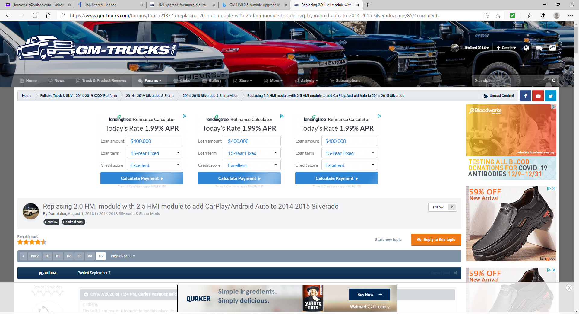

85 pages on this post to graze through:
I'm at page 71 of the 85 and still see no reference to someone attempting to play audio through a USB connected flash drive at the same time using the other USB port for android auto/car play to have navigation and have the audio cues and directions playing over the speaker.
All I want to know is if I can get the radio to combine audio like I know I can do with factory navigation.
