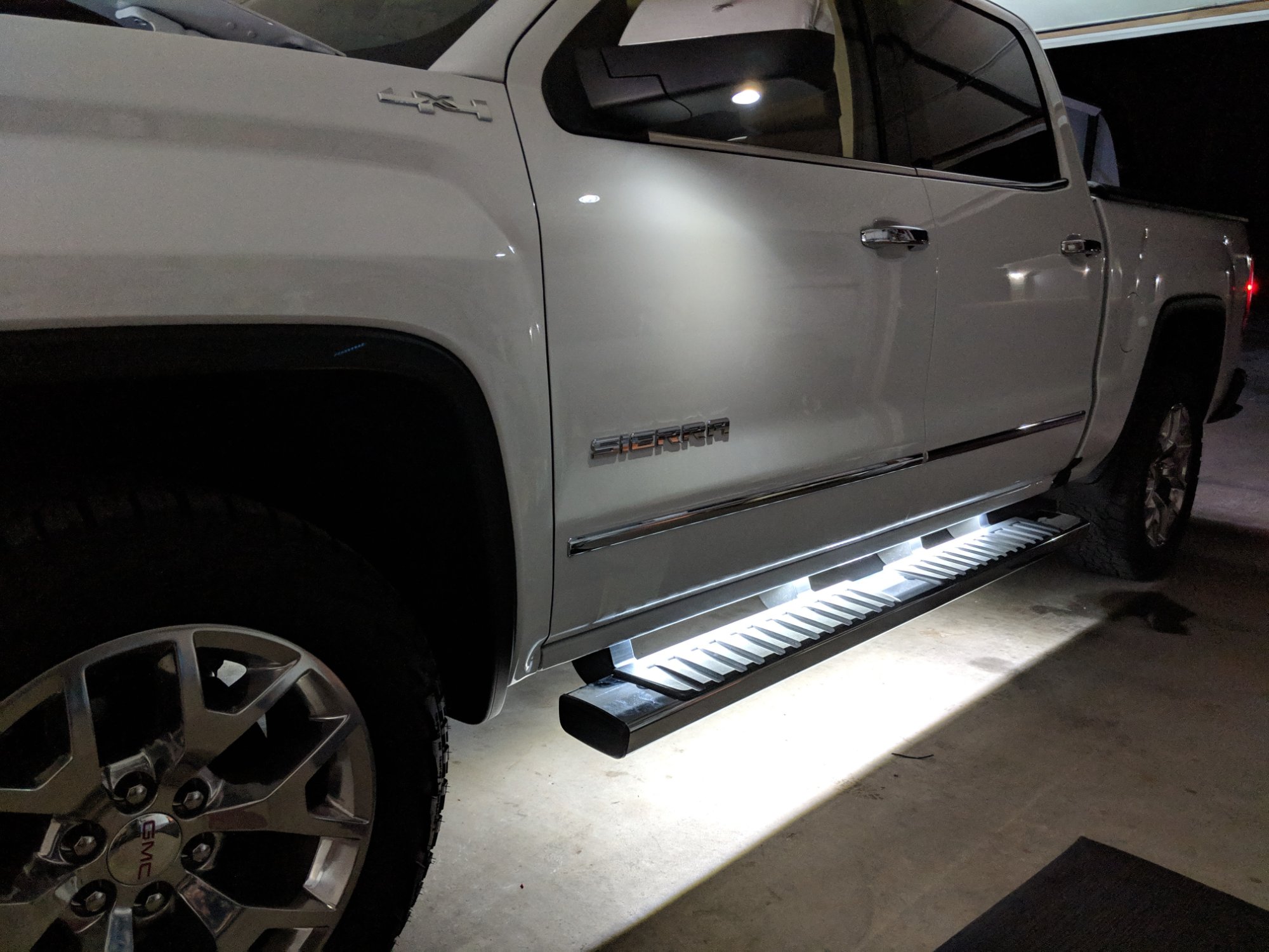

Reviving the dead here as I am looking to add lights to shine on my running boards. I did this on my 2015 GMC sierra 1500 using the puddle lamp circuit on the BCM. Does anyone know which wire this would be on the 2500HD? Picture for reference.
