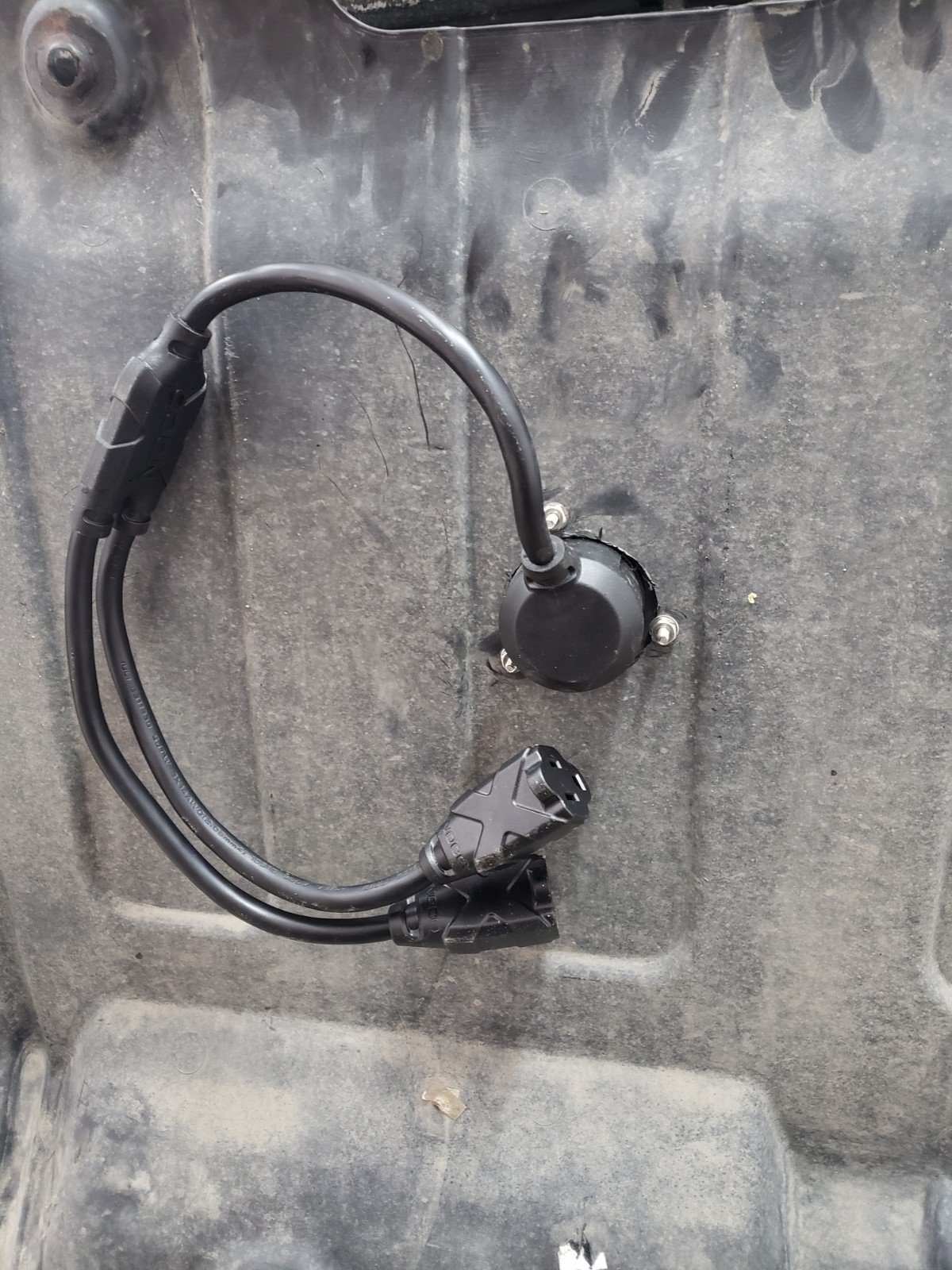

My truck came with a block heater. It was -20 last night here in Ottawa and no more than -15 today so I thought I would plug in the block heater and see how it worked.
I plugged in the heater cord that came with the truck and checked the voltage =120 v. Was curious about how much draw there is but my amp probe  showed zero amps
when plugged in. I checked the continuity of the cord, all good. I checked the resistance of the heater at the plug on the truck , it shows open circuit.
I read on other posts about block heaters that the thermostat is in the cord itself. It appears that GM has moved the thermostat into the heater itself on the new models so that
the cord cannot be tampered with. For me I would just like the heater to work when I want it to, not when GM feels its necessary, I think -15 is cold enough to warrant
use of the heater. Attached are pics of the cord  that came with the truck -2020 Sierra SLT

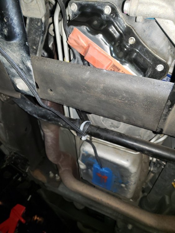

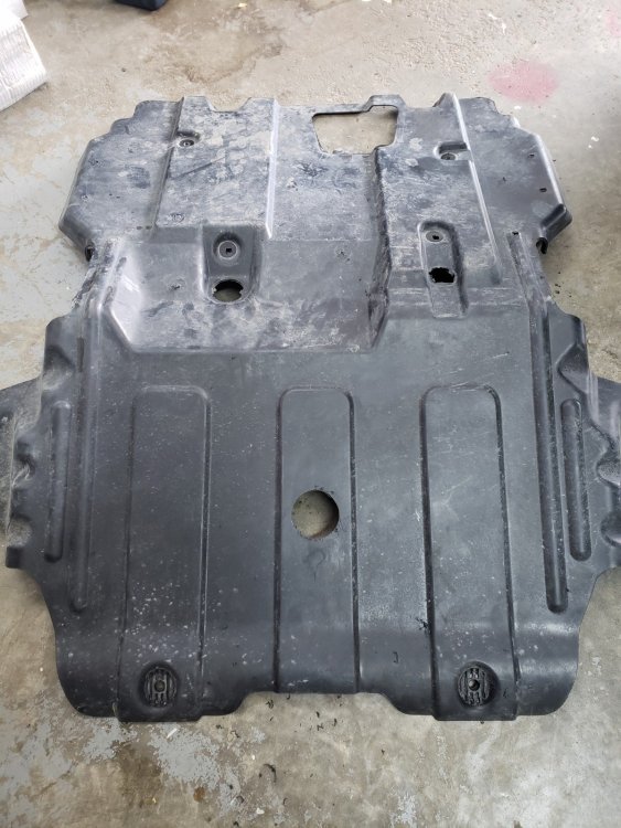

Two months ago, I cut a 2" hole in my splash guard under the truck and installed a "NOCO Splitter GCP2 15 Amp 125V AC Port Plug"
The NOCO splitter has two 18" extension cords.
I then bought a quality 3 way outlet (yellow) and secured it up under the bumper, inserted it into one of the NOCO cords.

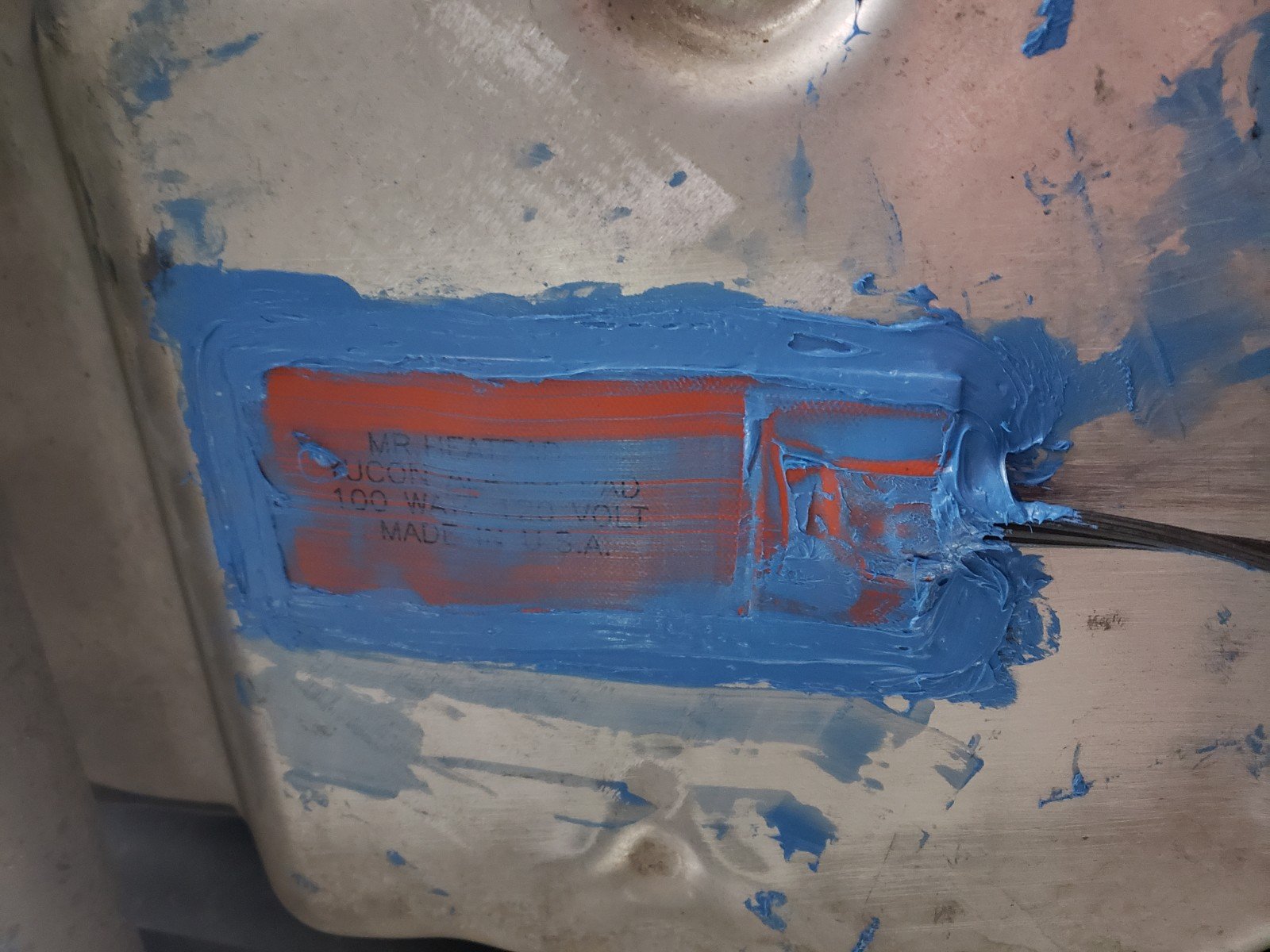

I installed an 125w Temro heat pad to the oil pan (with build in thermostat), as well as a 100w Besco/Alaska heat pad transmission pan. Also installed a 75w Kats battery blanket. Plugged the 3 of those into the yellow triple outlet. The oil pan heater was a pain because of the grooves in the oil pan, I had to get a narrow 1.5" x 3" pad that just barely fit the confines of the flat section of the oil pan without grooves. Applied a liberal amount of silicone to both pads after installation.
Plugged the factory block heater into the other NOCO extension cord.
So now when I plug my cord from the house into the splash guard, it powers all 4 heaters. The combined wattage does not exceed or trip the 15amp breaker. Slight nuisance to have to get down on 1 knee to plug it in, but everything seems to work great after 2 months.

It's clean and hidden. When I change my oil, after I remove the bolts to lower the splash guard, I just reach up and disconnect the 2 NOCO plugs then the whole thing is removed as normal for each oil change.
After a few hours plugged in, I find it raises the temperature on my transmission by approx 10 degrees Celsius. I can only assume the oil pan heater is similar. It definitely starts easier when it's -15 out.
