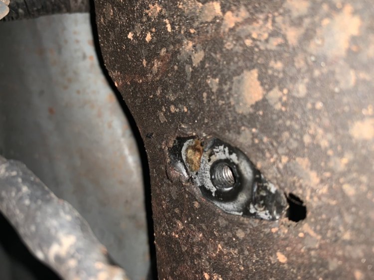

Check the ground connection on the frame, behind the passenger side front wheel, beneath the wheel liner towards the bottom. You can just hold it back. Requires removal of nothing if you turn your steering appropriately.
Remove the ground bolt, clean up the mating surface, put it back, and try that for a little while.
1st pic was what it looked like from factory after I removed 10mm bolt and neg cable. 2nd and 3rd pic after I wiped off wax with a paper towel.
Will have to give it a few days or weeks to see if I get service stabilitrack message again.
Nice.  I wire wheeled the mating surface on my Yukon, then painted it once reassembled.  I did a better job than the dealer tech did which is why I investigated this after receiving back from the dealer.  So my problems were either THIS ground or the ECM as both were dealt with simultaneously.

Update: cleaning the wax off frame and negative cable didn’t solve the random service stabilitrack message. Still had a month of warranty left so took to dealer. They replaced negative battery cable due to high resistance. Hopefully that solves it.
