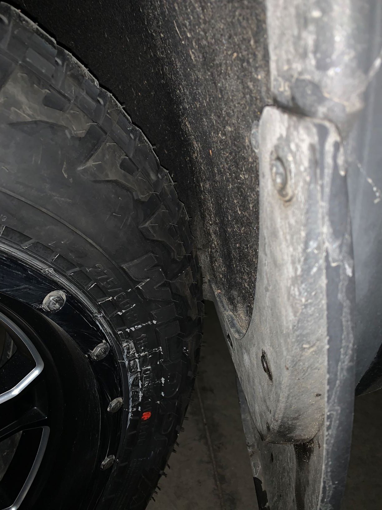

I have 275/60/20 Wildpeak AT3W on my 20x9, 0 offset ProComp wheels. I rubbed on the splash guard and wheel liner even with Bilstein 5100's at max height (1.85" of lift in the front). Trimmed the flaps and zip tied the liner back and it helped, but on large incline driveways I still rub in reverse at full lock. About an inch more of negative offset from my factory honeycomb wheels so no issues with rubbing on sway bar or UCA. Picture shows where it was rubbing prior to trimming, only had about 3/8" gap from the tire to inside of the splash guard. At about 0.75-1" now. Not stock offset but hope this helps..
