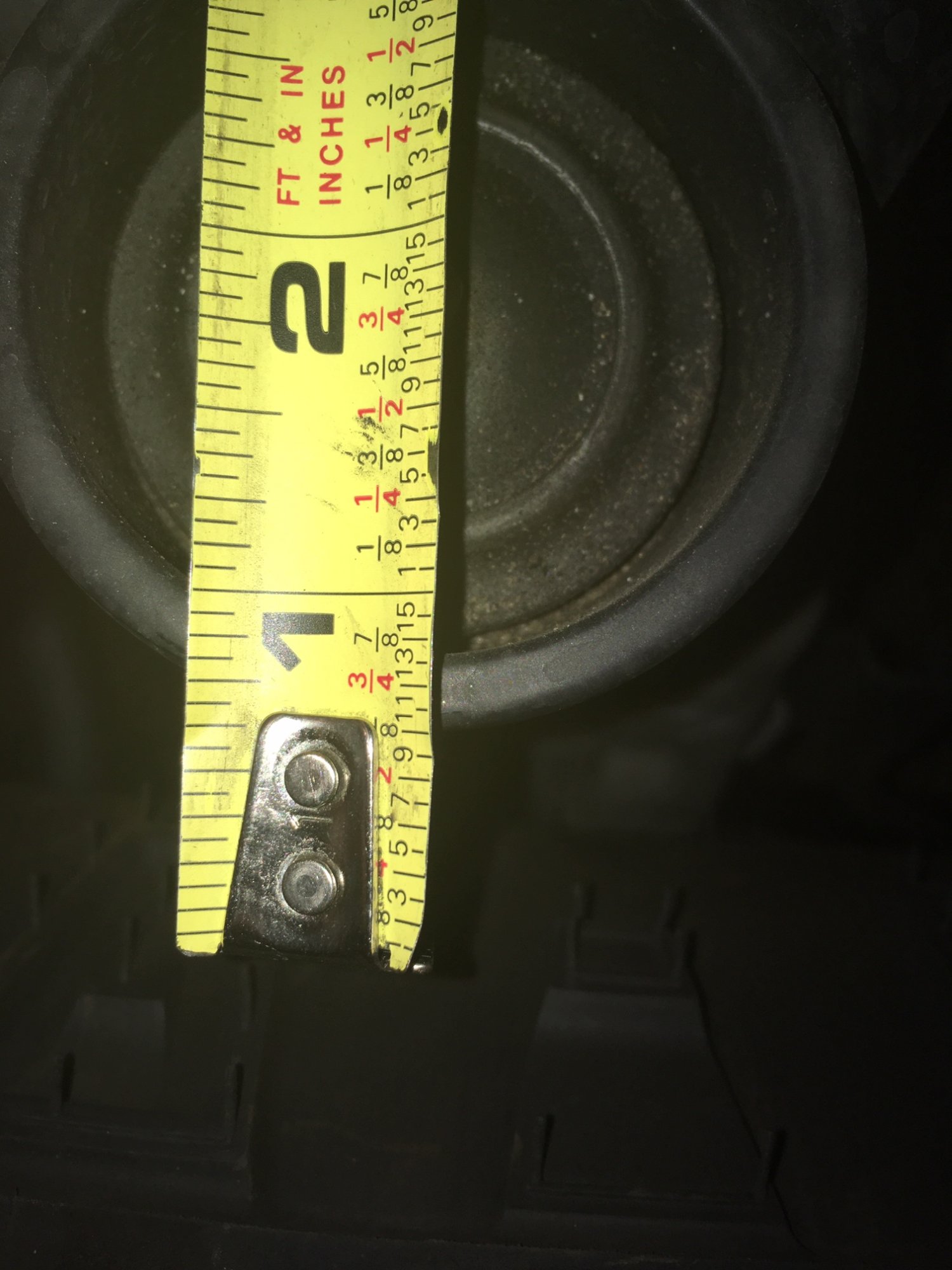

WHEEL QUESTION - DON'T KNOW ABOUT 20'S BUT FOR REF - THIS IS 275/65/18 ON METHOD NV 18X9  W 18MM OFFSET - ONLY ABOUT 5/8'S OF AN INCH CLEARANCE TO UCA
