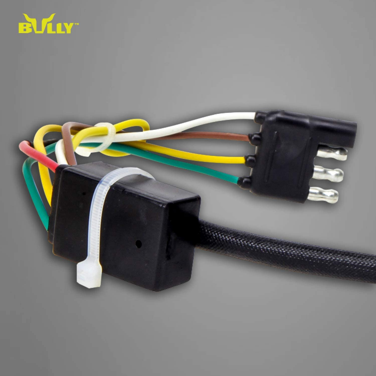

CURT 56584 Replacement Vehicle-Side Custom USCAR 5-Pin Trailer Wiring Harness
CURT 58030 Trailer-Side 4-Pin Flat Wiring Harness with 12-Inch Wires
Tonight/tomorrow, I'm going to splice the two together, so I'll have a 5-pin AND a 4-pin.  The 5-pin will be for my tailgate LED light bar, and the 4-pin will be for my tow hitch brake/tail light (Bully CR-007A).  The blue wire is tapped into the reverse thru the 7-pin connectors, which connect behind the 7-pin on the bumper.
I'm still debating putting the turn signal eliminator, from an old tow hitch brake/tail light, in the main harness for both the 4-pin and the 5-pin.
