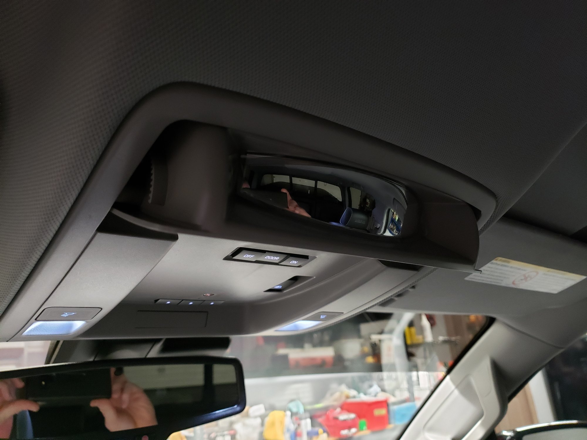

The 2015-2017 SUV OH console with the mirror fits as I put one in my 2016 Silverado.  If my records are correct, the part number was 23161771 but I'd have to pull it to be 100% correct.  Since it's a single compartment, the center panel swaps right over along with the harness.

For clarity, did you swap the entire OHC or just the mirror/shades flippy thing? Also, is that a rear power slide lever/switch on the RH side of the OHC? I'ma say "YEAH" -- the reflection in said mirror suggests 3 panes o' glass.  ?
@laughey I removed my original OH console and removed the center panel along with the harness and installed those parts into the 15-17 SUV OH console as I removed those parts from it and installed the SUV OH console with the pickup center panel and harness.
And yes that is the switch for the power sliding rear glass.
