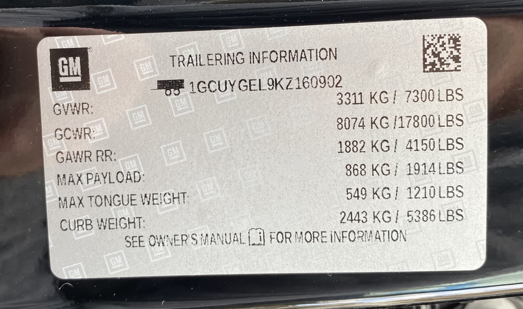

I would say see what max trailer trucks are payloading at.  Perhaps someone that owns one can post their trailer sticker from the door jamb so you have an actual payload # of one.  3.0 Duramax would be out of the question as most of the ones we've sold at work have a payload of 1500-1700lbs.  I'm not saying that a max trailer 5.3 or 6.2 can't tow your trailer, I'm just saying that the truck runs the risk of being overloaded really fast and that a 2500hd would be the safer choice.
As others have mentioned, while the OP may feel comfortable, it's highly likely he's over his payload capacity with everything he's hauling.  My 6.2L Max Trailering equipped truck has a payload capacity of 1910 lbs.
OP has a 2013 crew short box 1500.  Those had lower payloads than the new trucks.
Take your sticker for example.  Pull the 1200lbs tongue from the payload of 1910lbs so 710lbs of remaining payload.  Then take away him, the significant other, two other humans and the dog (the 605lbs I had used).
That leaves you 105lbs of remaining payload for clothing, gear, coolers, kayaks, etc.  I would almost guarantee that in full camping gear, trailer attached, he is overweight on the truck itself.  He might not be over GCWR, but probably close to that limit as well.
