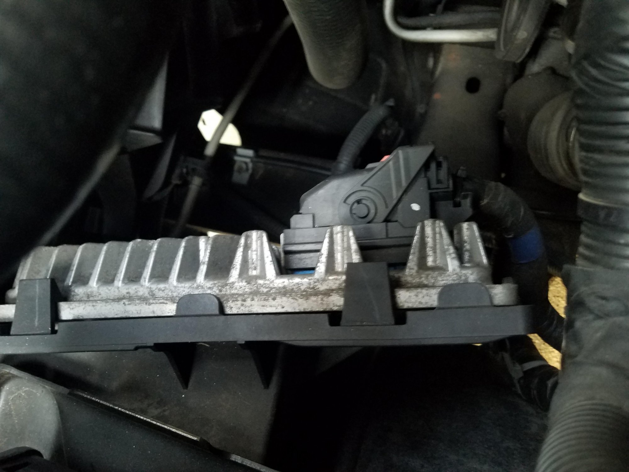

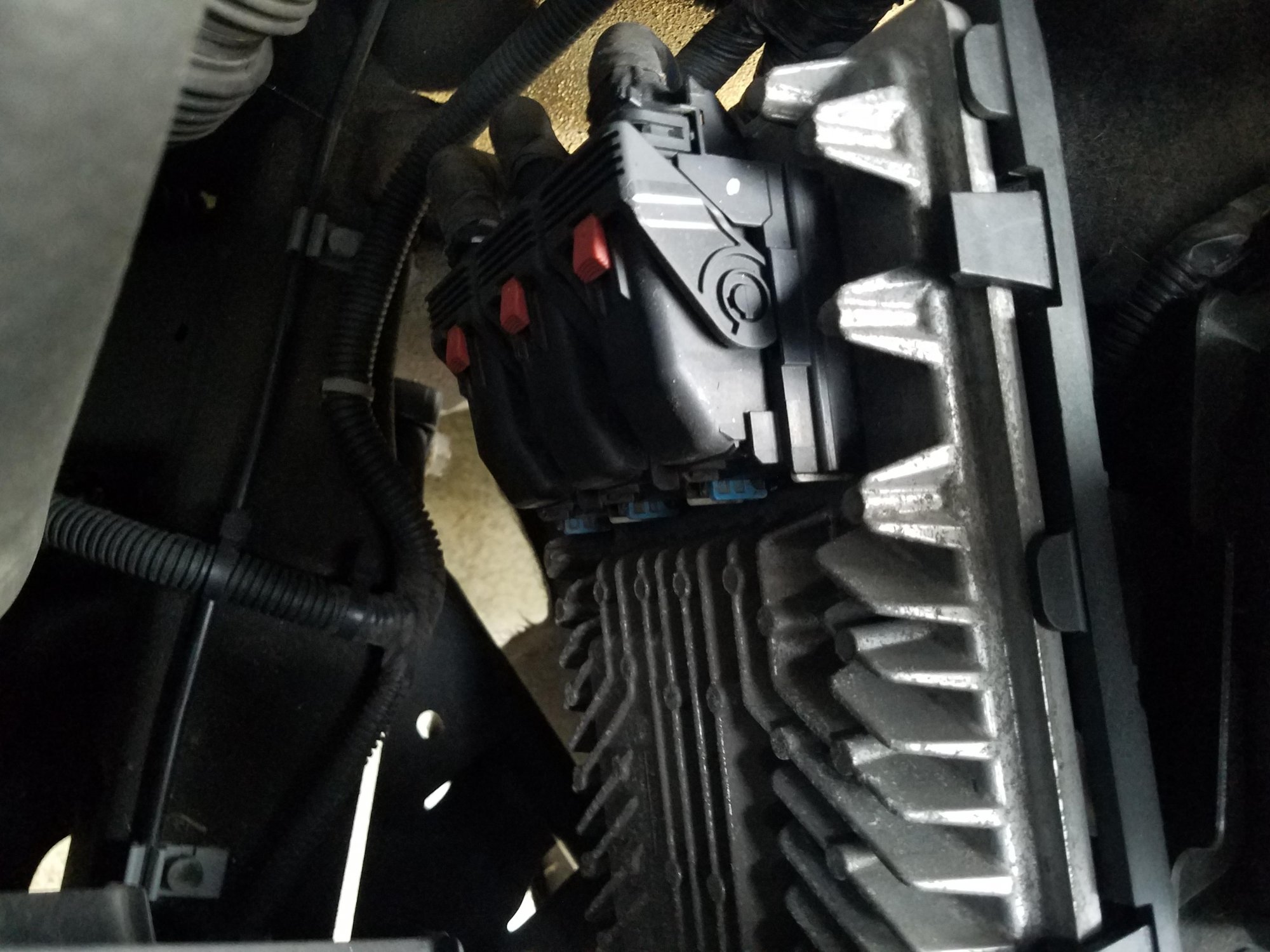

I just went out & checked my ECU. From what I can see, the ECU is only held into the plastic holder by maybe 4 plastic snaps; 2 top & I assume 2 below. The plastic holder is mounted under the spare battery tray. It would be pretty easy (if you knew what you were doing) to just undo the (3) connectors & pop the ECU out. Man, that's crazy. Making a steel box to surround the ECU & plastic bracket and the (3) connectors would not be an easy job. My hat is off to you for coming up with your steel box solution.
Now you have my mind going on some kind of retainer, not to make it bullet proof, but to make it more difficult to get at. Maybe some type of strap that goes over the (3) connectors & the plastic holder bracket. I'm thinking of something like metal zip ties or some other metal surrounding strap. Just thinking out loud.
With all the aluminum heat sink fins on the ECU, enclosing the unit might be asking for an over heating issue. Just sayin......
Wait, thats the ecu? Thought it was the big one over the wheel well. If thats the case you may be able to put a metal overhang over it screwed to the 2nd battery holder with special screws like those flatheads that are tighten only (seen often around bathroom stalls).
