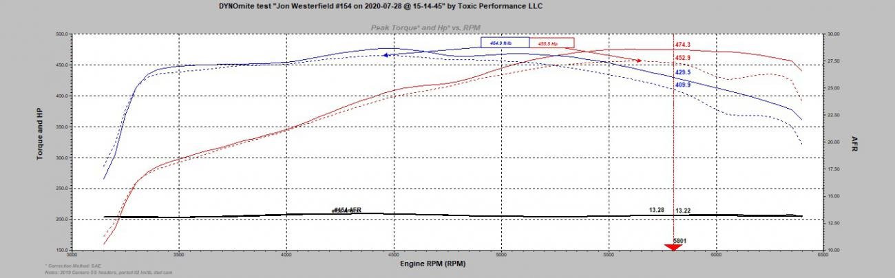

     L86 vs ported msd (full boltons/e85)

Yeah, its not an apples to apples comparison.. I'm just thinking the Camaro guys seem to be making power gains across the board with tuning (I'll try and find it). I think the LT1 has the same cam as the L86??
It does  really make me wonder if all that mid range power is just being moved up top. Its difficult to figure out because there all tuned differently stock. And it looks like the truck has massive gains everywhere compared to the msd with tuning...

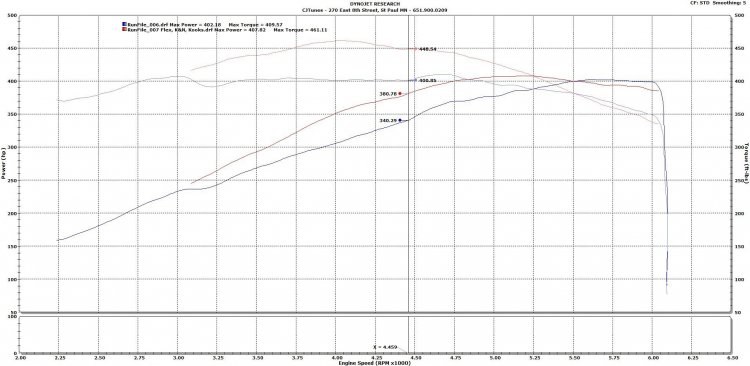

Here's the dyno of camaro lt1 vs lt2. Gains aren't as high as I thought they would be, but not bad.

The LT2 has a slightly different cam profile, but it appears that manifold is good for 22 rwhp on that camaro. Great for them, not so much for the trucks though.
